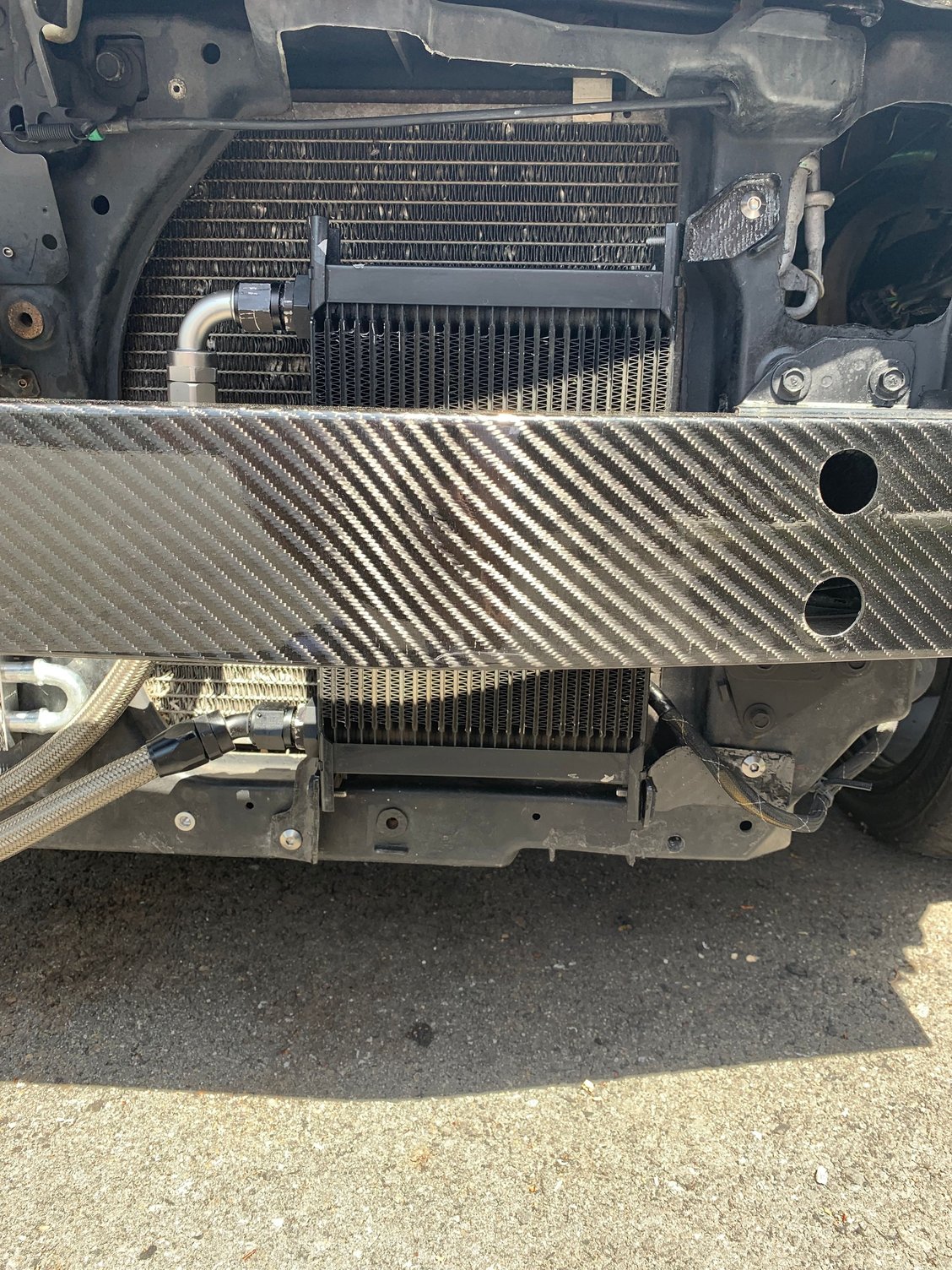

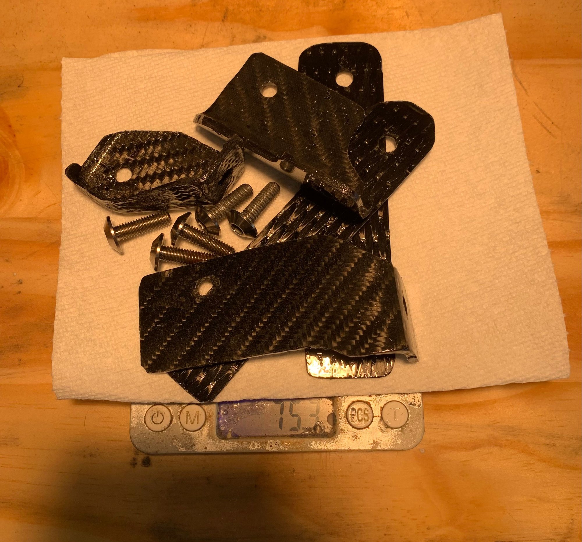

Minor bits and pieces finished. Got rid of a bunch of ugly and rusted looking brackets and made carbon ones from a few scraps and off-cuts of carbon fiber:
Before: 440 grams and looking ...rough thanks to the lovely Northeast weather
After: 75 grams and most importantly , no rust !
Flipped the oil cooler mounting by 90 degrees, had to add a new AN fitting. Much cleaner with the new brackets.
Added new power steering cooler. Fits great and it was super cheap in case any of you guys want to get rid of your old one:
Amazon Amazon

Id love to see how you make this stuff, you should make a YouTube Channel!
im going to buy that PS cooler and figure out how to do oil cooling. Did you just use a sandwich plate?

I would love to share more about the process as it's rather fun for me, just the biggest challenge with videos is the lack of time to prep, edit, etc. Maybe if I just keep it super simple for now (go pro on the head and little to no editing). But yea, thanks for the idea.
As for the oil cooler, Z1 offers a basic kit that comes with a Mocal sandwich plate and the required hoses. I'd recommend doing that. Mine is exactly that except I modified one of the AN fittings and the brackets to get a different installation orientation.
Z1 kit: https://www.z1motorsports.com/z1-pro...211660a27e0708

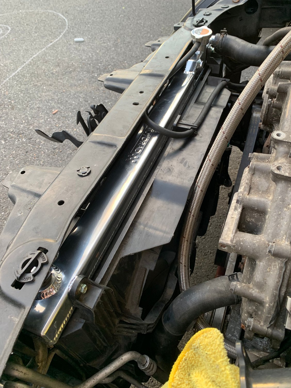

Another small item crossed off the list
the fitment is honestly very good, better than I expected.

I was eyeing a replacement option for my stocker. Glad to see this is easy drop in replacement with stock fans. I have some aftermarket fans so it should be a non-issue.

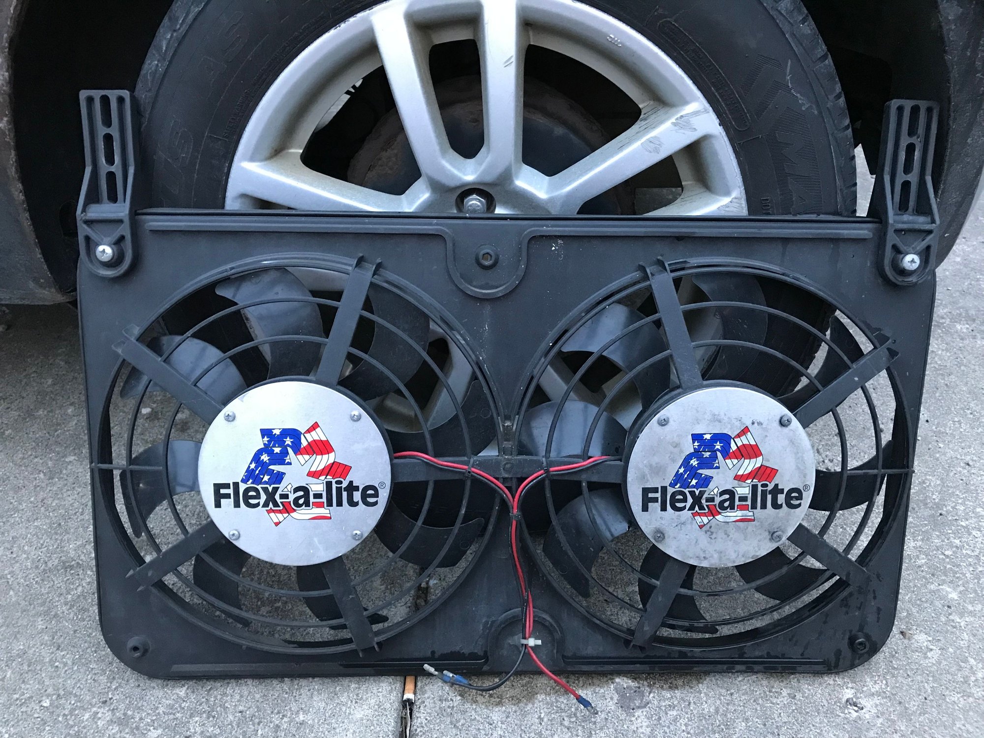

what fans do you have if you don't mind me asking? I'm looking for a slim solution. The koyo radiator fits perfectly with the stock fans, but I'd like to get back some space between the radiator fans and the engine block for...another idea. I've even considered retrofitting push fans in the front of the radiator/AC core assembly like in older BMWs, but that would take a bit more engineering vs just a slim fan assembly.

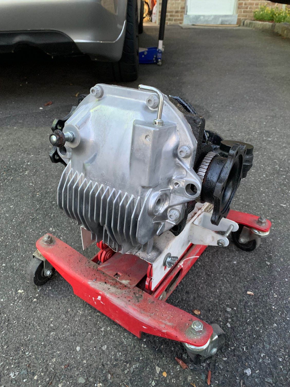

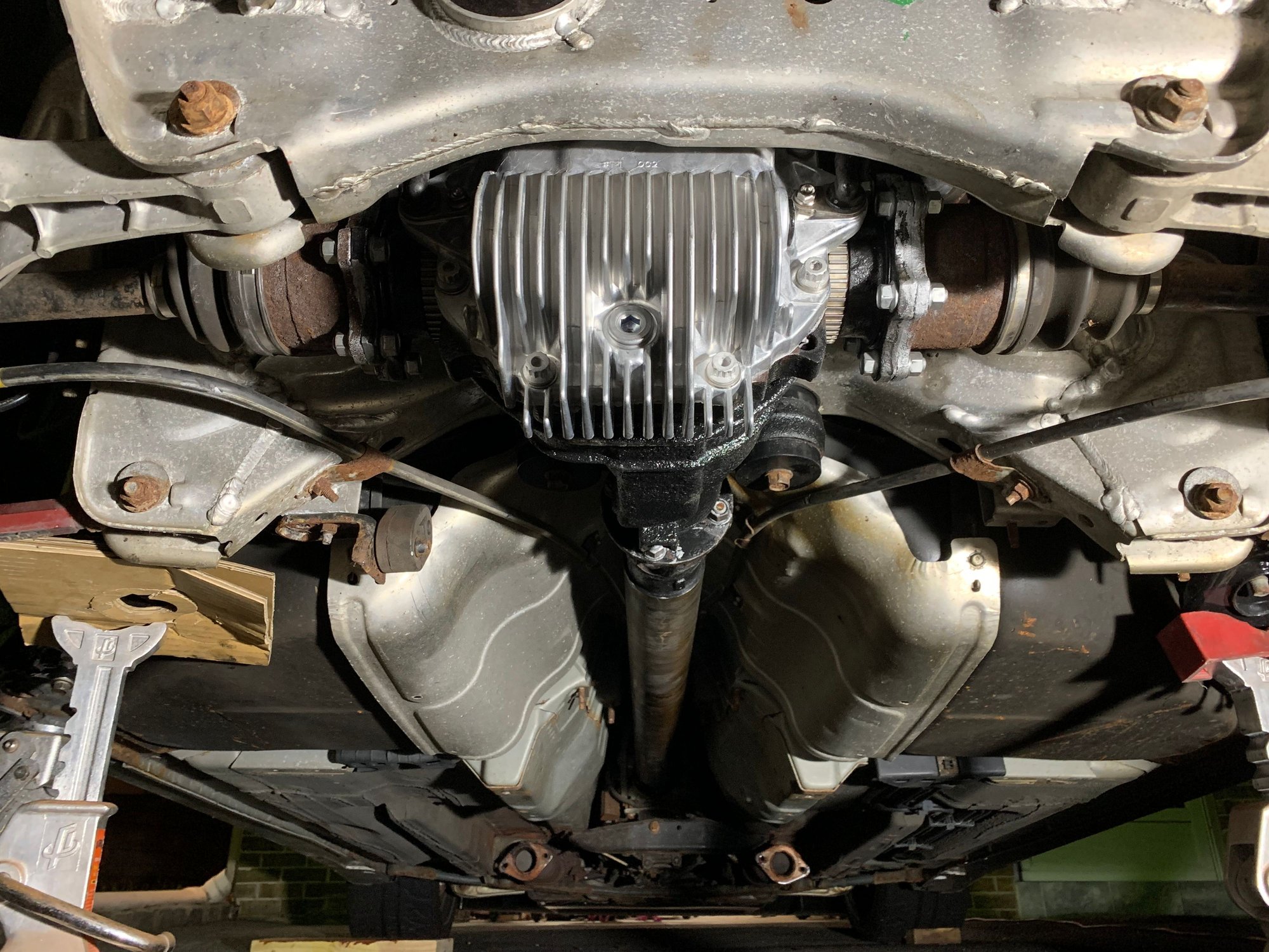

I installed a Tomei 1.5 LSD and restacked the clutch plates so that the thing doesn't lock up like a welded diff (Tomei LSD has a reputation for being super aggressive).
First impression is that it still pops around tight turns even thought its stacked at only about 50% (6 contact surfaces on either side vs 12 per Tomei factory configuration). I will see how it does at the track later this week and possibly take it apart again to restack the clutch pack or try a different gear oil first.
Flex a lite fans.
