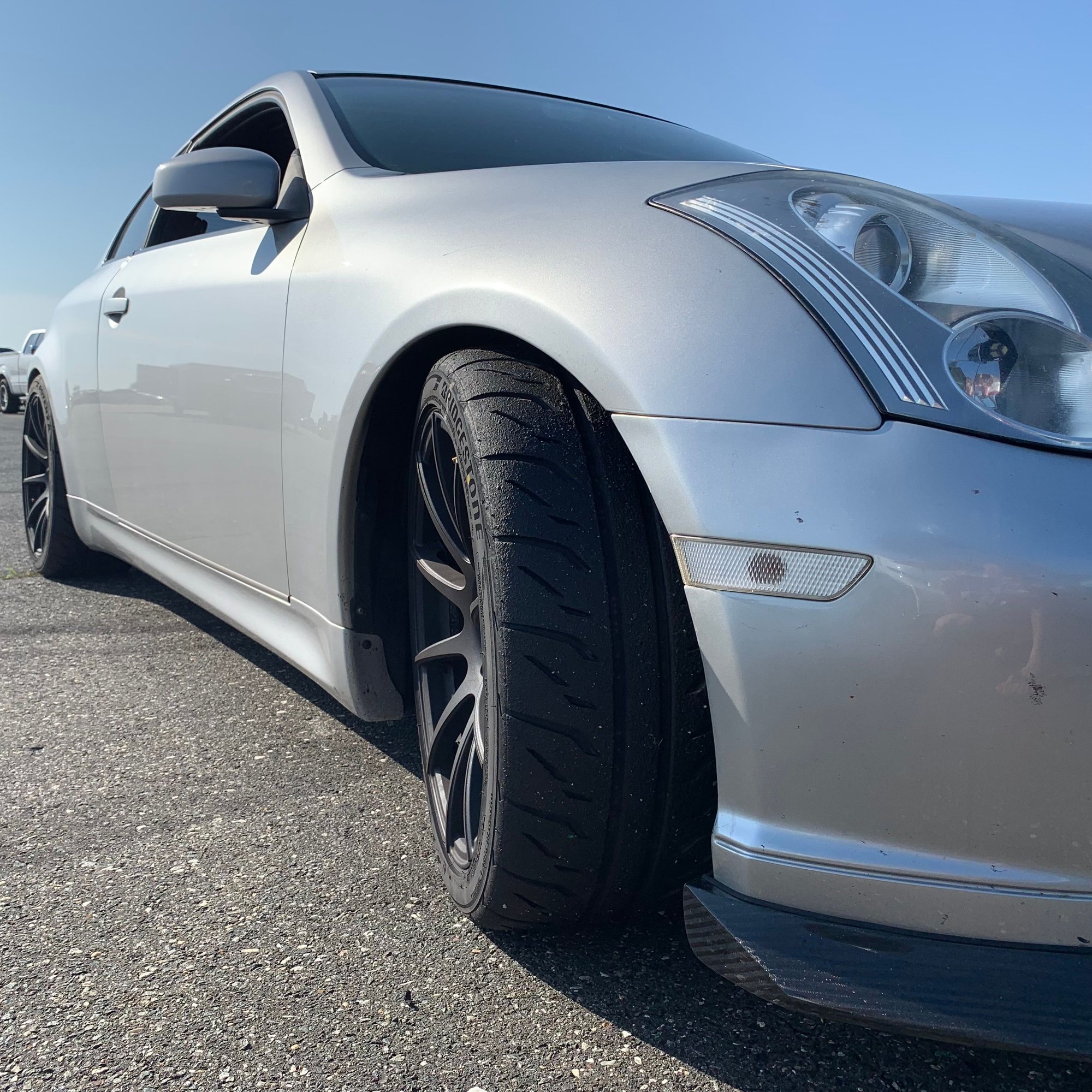

I did the same at NJMP in Millville, NJ:
Very happy with the new tires: RE71R. They gripped much better than my previous setup
I did run into issues with overheating despite the oil cooler and CSF radiators are still on back order. Does anyone have good radiator recommendations? Mishimoto or Koyo?

Mishimoto always makes great radiators, however I'm thinking you have something else going on because I've tracked my G pretty heavily over the years on the stock radiator and never had an issue. Might be a symptom of your fan motors starting to fail.

You are def correct in that it was something else. It really was primarily due to some air pockets that were still present in the system. I ended up spending half the day bleeding the system and by the end of the day I was able to make it to the end of a session without overheating excessively. Additionally I think because I now have a splitter with an integrated non-vented undertray that goes all the way to the front crossmember I now have a bit of an airflow problem across the radiator (no good exit for the air), so it would seem I now desperately need a vented hood.
I'm thinking I will design a CF cut and drop in solution for the stock hood. If anyone is interested I could make it available for others once the molds are made.

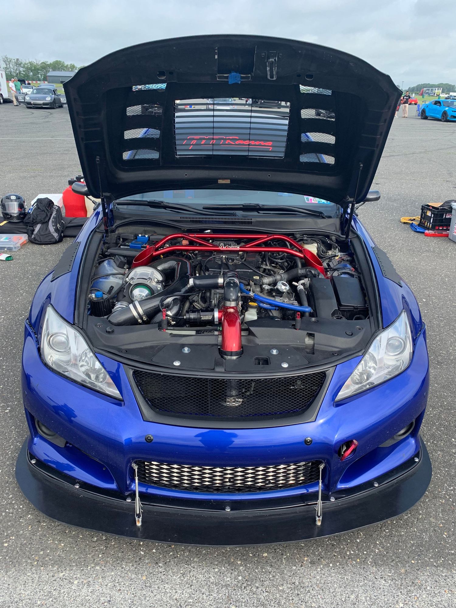

As for the RCF, surprisingly enough I actually saw 2 of them at NJMP during the last track day and a supercharged ISF to boot (owner of RR Racing was running laps in it), pic below:
Cool car and sounded very mean. Def better noise than the relevant German vacuum cleaners (current gen M3s,M4s, etc.)
