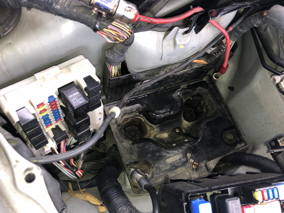

Ended up taking on some water when the drain clogged in the battery tray/passenger electronics area. Drilled some small holes on the battery tray so it doesn't fill up, and cleaned out the clogged drain.
Car wouldn't start Sunday. Didn't think about that IPDM area drain issue I've seen here plenty of times. Turns out mine was flooded. Hopefully my little bit of work fixed it, and I tried my best to over dielectric grease up the IPDM to hopefully keep out water and corrosion in the future.
