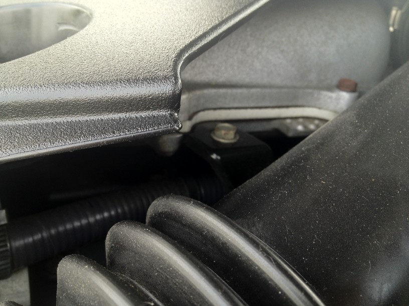

I don't know if this spacer that I see is standard on these cars, or if this thing is a plenum spacer.
[You can see the 'spacer' or whatever it is in that picture, taken from the drivers side with the intake tube in the way]
I've searched and searched to get an idea of what should be there in stock form, and I'm just not sure.

Looks like you have a Motordyne 5/16" spacer, score!!!!!

looks like you do have a spacer, they did not come stock so i guess the last owner added it

That doesn't look like the stock Infiniti intake either. Looks like you have what is known as the Z-tube (OEM intake off a 350Z). The spacer and z-tube are typically the first mods done to a G. Wouldn't consider those parts bad things either.
Edit: If you have an 05 6MT, then you have the REVUP engine, the spacer requires another product from Motordyne called the MREV2, let's hope the previous owner did his homework and hooked you up!
