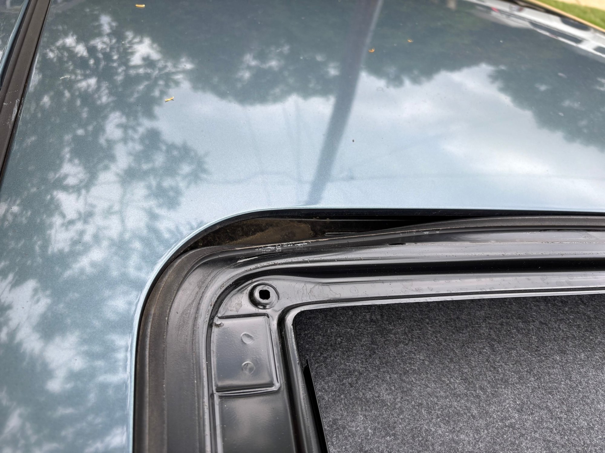

Dang. I'm the latest victim of this. Unfortunately, when mine let loose, it bent the frame. This is going to be a pain!

Originally Posted by HoserG35
that’s crazy. I’m assuming the glass flew away and shattered? hoping it’s an easy fix for you.
Well, I was moving 80-85 to get around a left lane idiot on Xpressway. Did not see the glass at all in a quick mirror glance, but nobody was swerving behind me. The passenger side rear corner is the part of the frame that is bent. I'm assuming that was the last bit to let go as the glass peeled away and the panel flew off to the side of the highway.

Originally Posted by Mr.GEE
Find an aluminum plate and shape it like the glass and bolt it to the frame. It can be painted the same color as the car or wrapped. Just my dumb suggestion.
Not so dumb. I rarely use it anyway. I'll see what the repair quote is. Probably horrendous; headliner has to come down to replace the frame, I believe. This is a modestly attractive bailing wire and bubble gum solution. A little prying on the bent corner to bring it back close to level with the rest of the frame, and then a real juicy epdm or silicone gasket between frame and aluminum panel. Would like not to have a bunch of wind noise as an outcome.... Probably ream out the sunroof drains while I'm goofing with it, too. Can't do that preventative maintenance too often!
UPDATE: Dealer doesn't diddle with 20 year old sunroofs. Neither does the body shop the dealer recommended. Ended up with the accessories and repair specialist that the body shop recommended. Only thing available is "reconditioned" glass unit. Basically a junk yard-sourced unit that had a scratch. They took 10% off the quoted price for the scratch. But it's still a 20+ year old unit that will probably have the same issue at some point down the line when the adhesive dries out. But we know it didn't fly off when somebody wrecked their G, so maybe it will endure!
