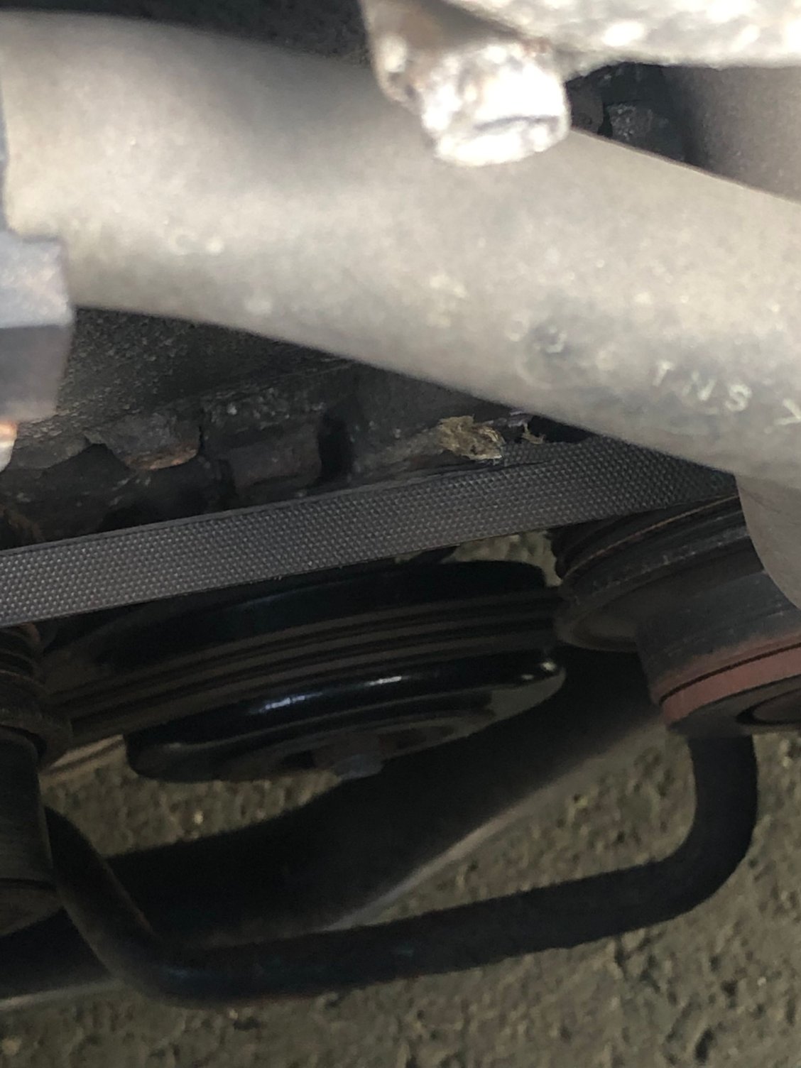

So I i don’t drive my g as much since I’m just learning on it but today I took it out for a spin and noticed my power steering had gone out riding pretty stiff and my tire pressure light flashed.The car has been sitting for about a week with no driving at all.I checked through the forums and they had said to check my belts and I did and to my surprise I found this ripped belt.Is this the problem why my steering went out?

I suspect not since the belt would at least still be spinning the pulley, however it's possible that due to the reduced surface area it might be slipping on the power steering pulley to some degree but NORMALLY you would hear a violent "screeching" sound when a belt is slipping.
I would start by checking the power steering fluid level, replace the damaged drive belt, see if the problem corrects itself.

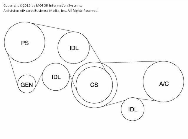

Yes that is the drive belt for the alternator and power steering, I verified the part number and the one you have is correct. Make sure to tension it properly or you will damage pulley bearings by putting too much tension on them. You will almost definitely need to re-tension it in a week because they stretch slightly.
Here is the routing diagram in case you don't have the sticker or don't take a picture before removing the old one. The easiest way to access the tensioner is from below the vehicle unless you have small arms and can fit them between the timing chain cover and the fans.

Mine is I believe the CS and A/C belt so idk if it’s the same

CS = crankshaft
A/C - Air conditioning pump
There is a single IDL = idler (where you tension the belt on that belt), that belt is at the very bottom of the engine.
The other belt drives:
PS = Power Steering
GEN = Alternator/Generator
and is driven by the CS = Crankshaft
the top IDL = Idler is just a blank, it's a holdover from the early 2003 model year that used to have a mechanical radiator coolant fan installed in that location
the BOTTOM IDL = idler, is the tensioner for the accessory drive belt.

I’m not mechanically knowledgeable haha mine is the Cs and Ac that is ripped the one in blue so I’m assuming it’s the same belt as the other belt

Ok the Air Conditioning belt is Continental part # 4040372
