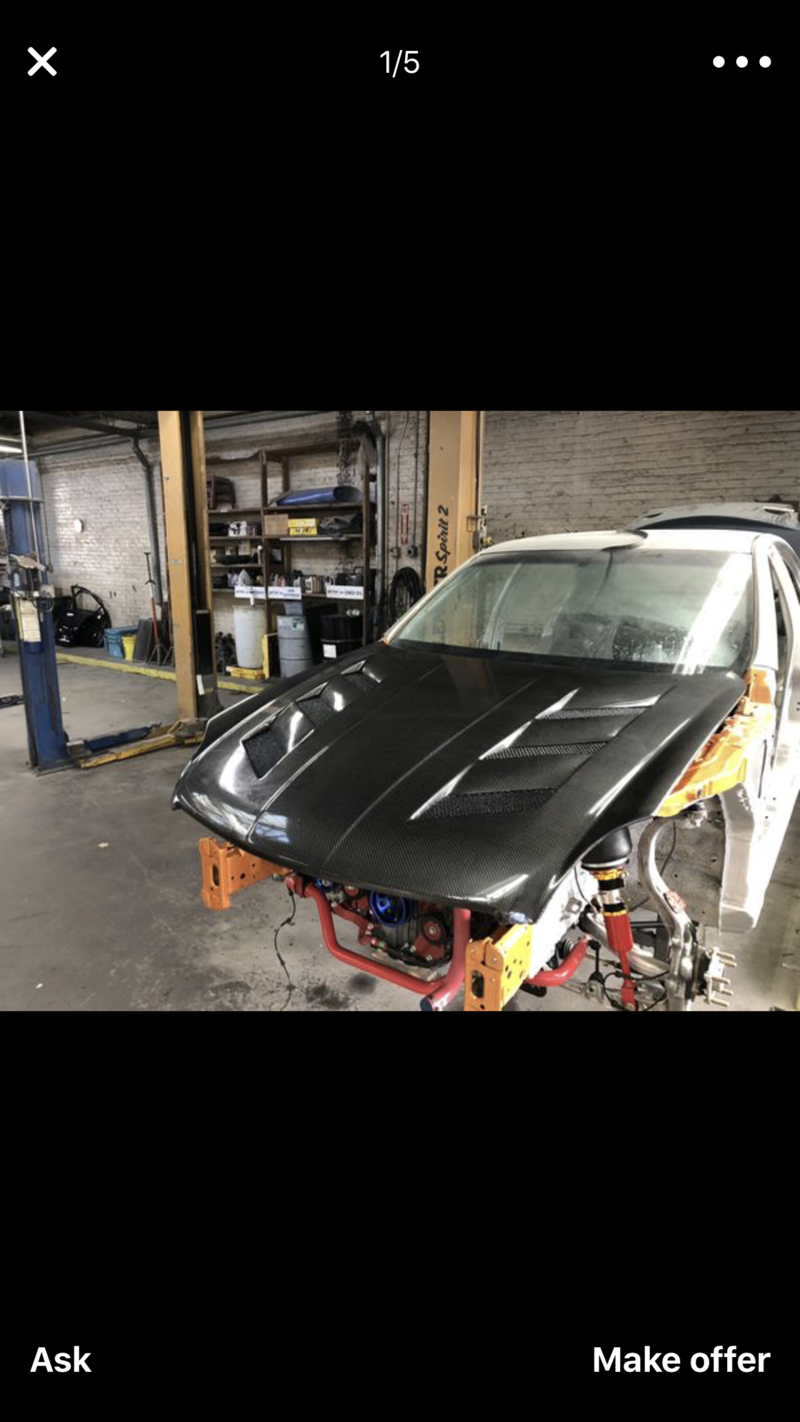

I’m considering picking up a VIS hood tomorrow from a guy on offer up who’s selling it for a good deal but before I put the okay I got a couple questions before I purchase it.
1st:Is installing it fairly easy or do I need a pro to install it ?
2nd
Do I need hood pins? I’ve heard horror stories of the aftermarket hoods opening up at high speeds on the highway and I want to avoid it at all cost.If so how does one install them?
3rd:The vis hood has ventilation holes but I’m wondering if that’s going to be a problem if rain/water goes in my engine when washing my car?
thank you

1: shouldn't be a problem, see YouTube, or some of the write ups here.
2: no clue
3: Non issue. Intake is really the only thing you need to be careful around.

Ran one for 5 years, never needed pins.
Install is easy, 2 bolts on each side. Might need someone to help hold the hood.

You don't NEED pins but I strongly recommend using them, so does the manufacturer. Since the CF will shatter instead of bending like the OEM metal there's always that chance that something starts to fracture and with a 160mph top speed it's a good way to lose your hood and probably the windshield.
