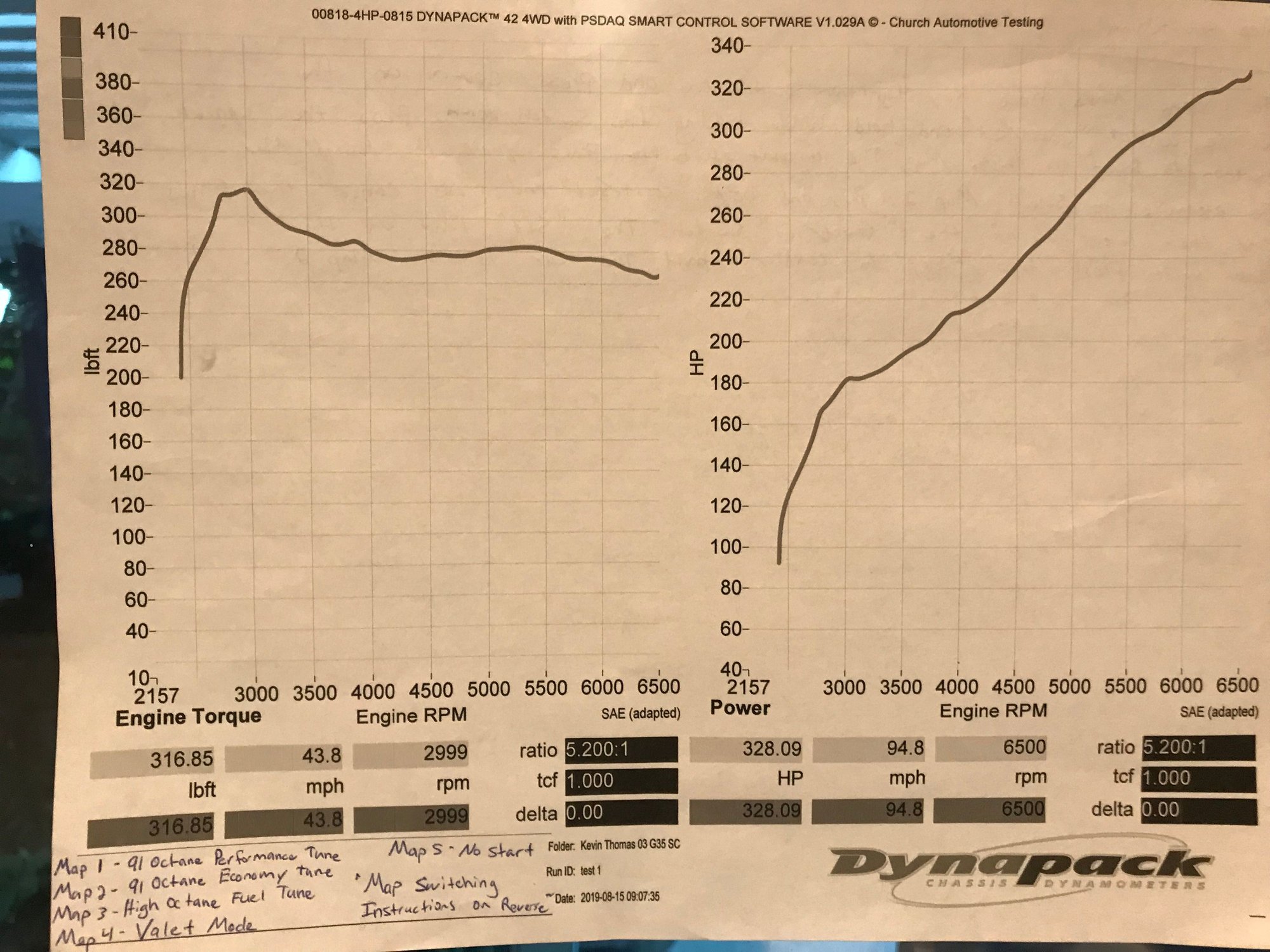

Dyno Results
So I finally got the G back from Church Automotive Testing in Wilmington California. A big thanks to Shawn Church, Ryan, and Daniel for all their hard work. I was very particular with how I wanted things and they were very patient. Even went as far as to smooth the transmission shifting to work better with the tune. It was tuned on a Dynapack using Osiris UpRev. There are five maps including the performance tune, economy tune, race fuel tune, valet tune (will not allow the car to go over 3000 RPM or 45 mph), and anti-theft/shut down tune. Maps can be easily changed with the flip of the cruise control buttons,
The car performs much better than it ever did with the Stillen Supercharger tune in a box. Shawn told me that it is a very conservative and safe tune. He had the car up to 350 hp, but dialed it back a bit since he knew I was selling the car and wanted to go with a safer tune.
Here are the Dyno results:
I have been driving the car around as stock for last several months, hoping that someone would buy the car as is and I would not to have to invest the time to install the fuel pump/fuel injectors and money for the Dyno Tune. The car is so much more fun to drive with the supercharger and the tune results were pretty impressive for this type of supercharger. Thanks for looking and don’t hesitate to contact me if you have any questions.
