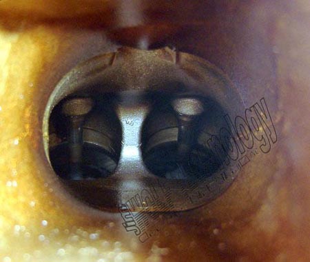

We all have been waiting for what the New Generation of VQ is, looks like, and works...this is sooo cool...the new VQ for the coming cars. Take a look. Don't know how or why JWT has this motor (car), yet I am glad I get to look at this stuff first hand.
http://jimwolftechnology.com/vq35hr/index.htm
Thanks again Jim and Clark for sharing.

My first question which was not answered here is, are the two TB plenumed totherther or does each TB serve three intakes?
I can also see LOTS of room for plenum development!
