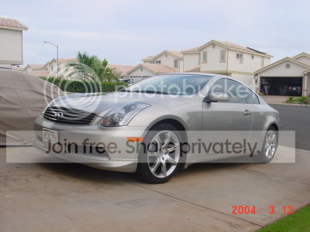

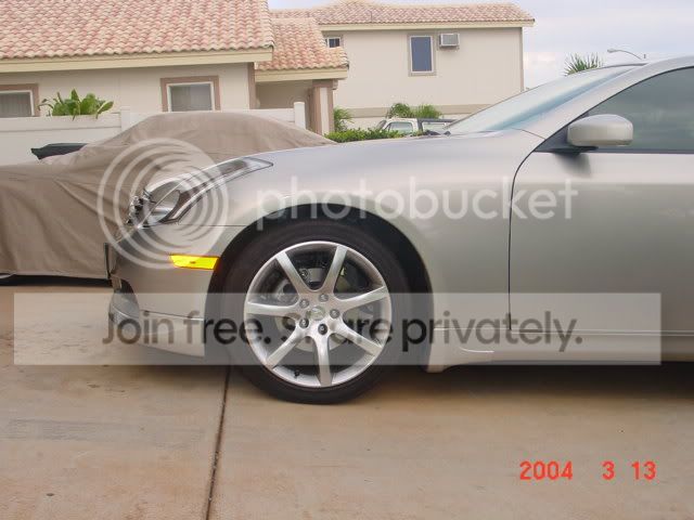

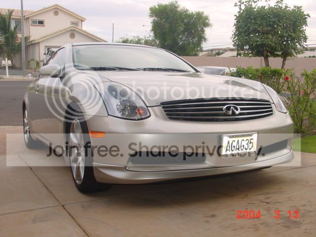

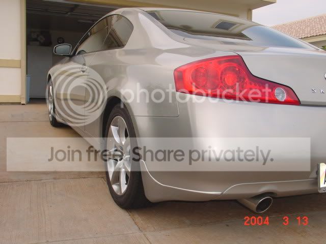

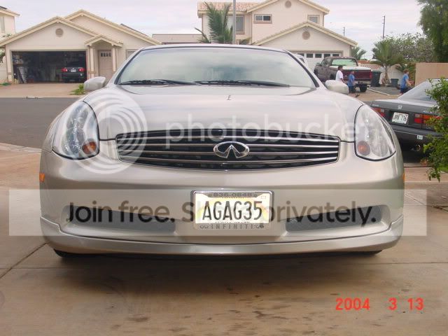

Here some pics after my install of the front lip and splash guards.

yo Fred that [censored] looks hot, got to get me some now.
The front lip looks like the color is a little off, does it match and it's just the way the light is reflecting or is it a little darker.
Re: Front Spoiler Install Observations
Wassup Craig. Good observation on your part, yes the lip seem a little lighter in color because of the brand new finish and the fact that my G is not garage kept and needs a new coat or two of Zaino. At first I thought they sent me the wrong color but I checked the code and it was the right one. Overall I'm happy with the end result, besides you can't beat the price on DIYs.
