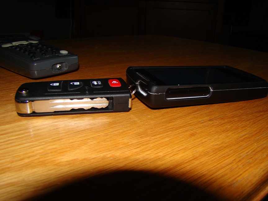

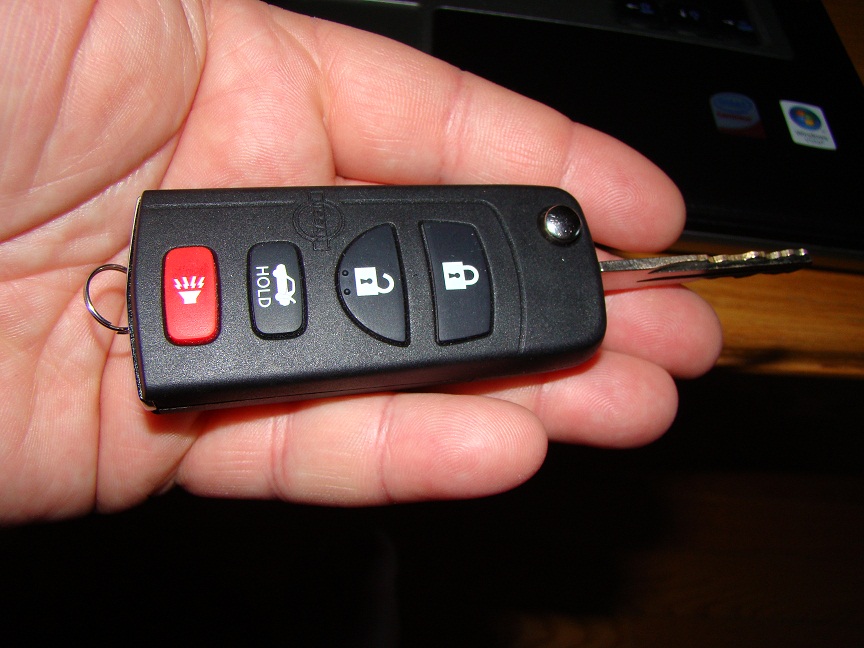

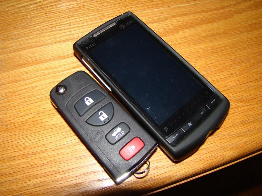

Solved!!!
Hey guys,
I've been following this thread for a while. I was never happy with the unrealibility of this mod, and the lack of ease in which this could be done.
With a little searching, I found this. This is what I bought,
http://cgi.ebay.com/ebaymotors/ws/eB...m=280366687005
I bought one of these and took my old transponder out of the OEM key and put it in this one. The electronics from the old fob fit perfectly in this housing and it comes with new rubber buttons. I just took it apart, took the key blank out and brought that and my old key to the local hardware store and they cut the blank for 2 dollars. Works like a treat, feels great in my hand, isn't too big and looks awesome. This took me all of 10 minutes to do once it arrived - no fuss no muss.
You be the judge
