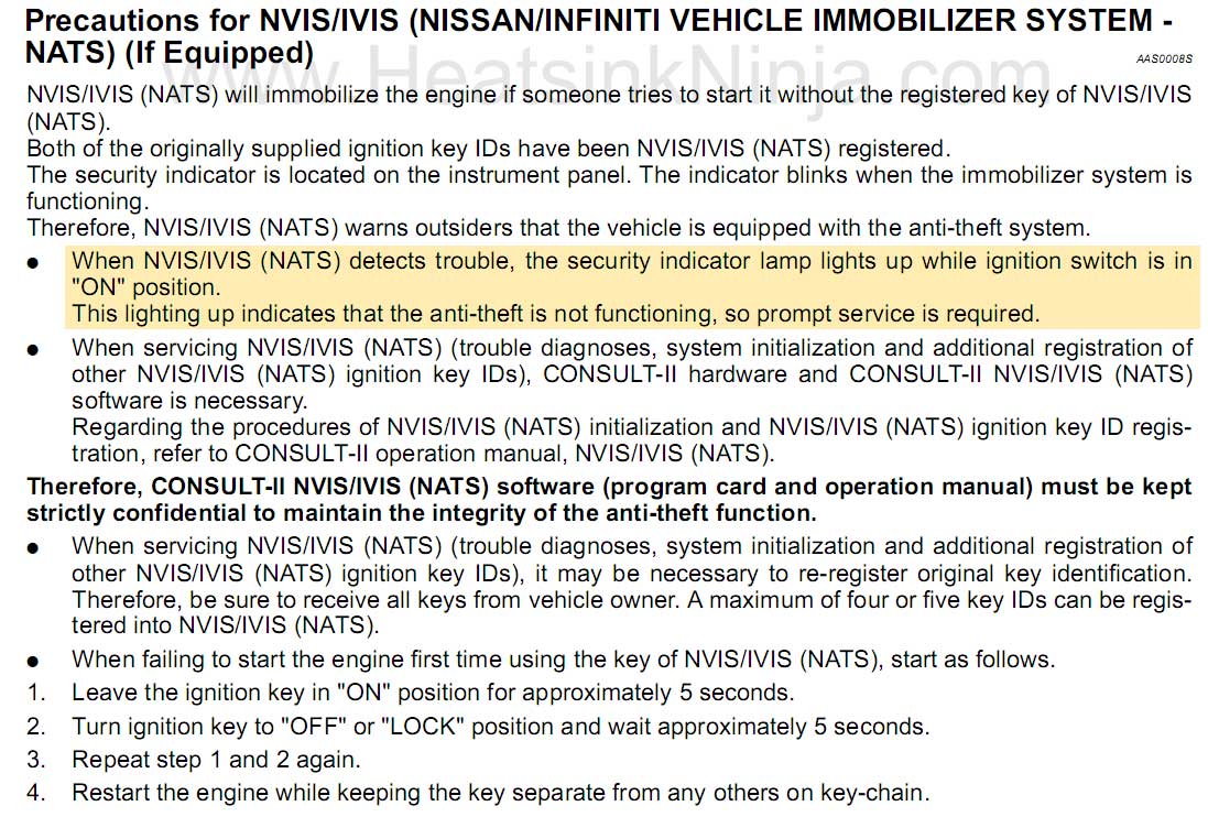

looks like it could be a problem with the alarm.

Originally Posted by falcor
Are you reffering to a separate alarm light or the immobilized light on the driver's side dash?
Light on the dash . There is no fuel supply nor spark. I am going to have the key reprogrammed again and see what happens.
