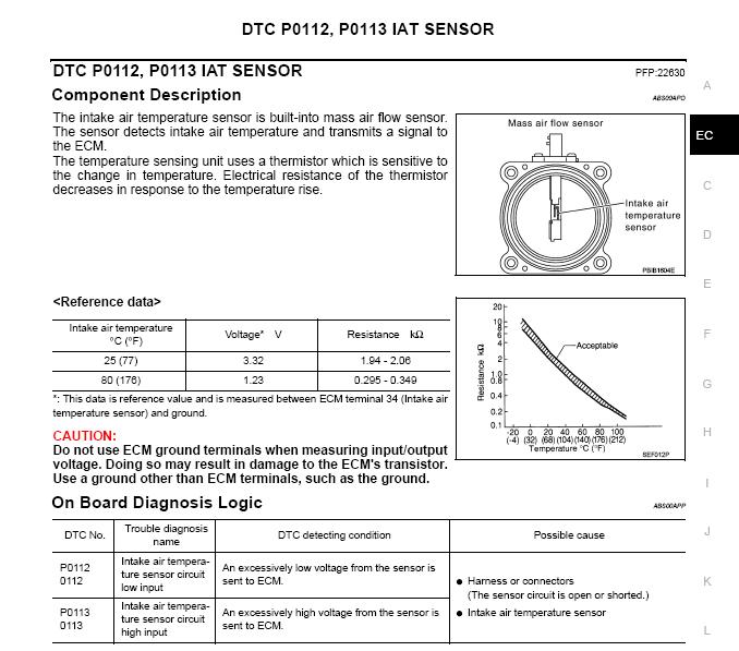

See attached from the FSM on P0113. It's not the MAF sensor, it's the Intake Air Temp sensor. Did you check the resistance of the IAT sensor?
Attached Thumbnails my car didn't pass smog test because of SES light (code P0113)-trouble_code_g35.jpg
