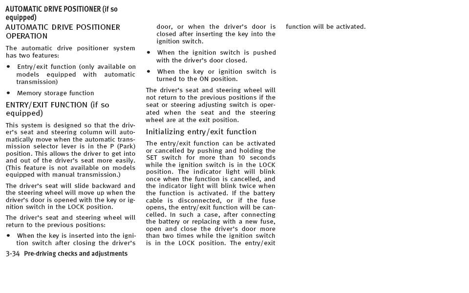

My '07 doesn't have an exit feature. Unless it is something you have to enable...
Old Jul 2, 2009 | 12:56 PM
RA031524's Avatar
Joined: Jan 2007
Posts: 531
From: Calgary, Canada
Here is the page from my manual. Since I have a 6MT, I won't have this feature. Guys with automatics should try it out and let us know if it works.
