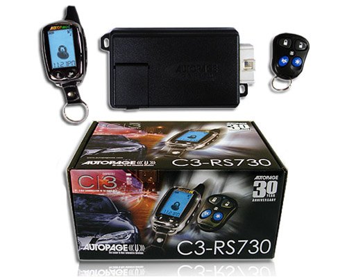

I also wanna get a alarm system with remote start, which one would you guys recommend besides the Viper
