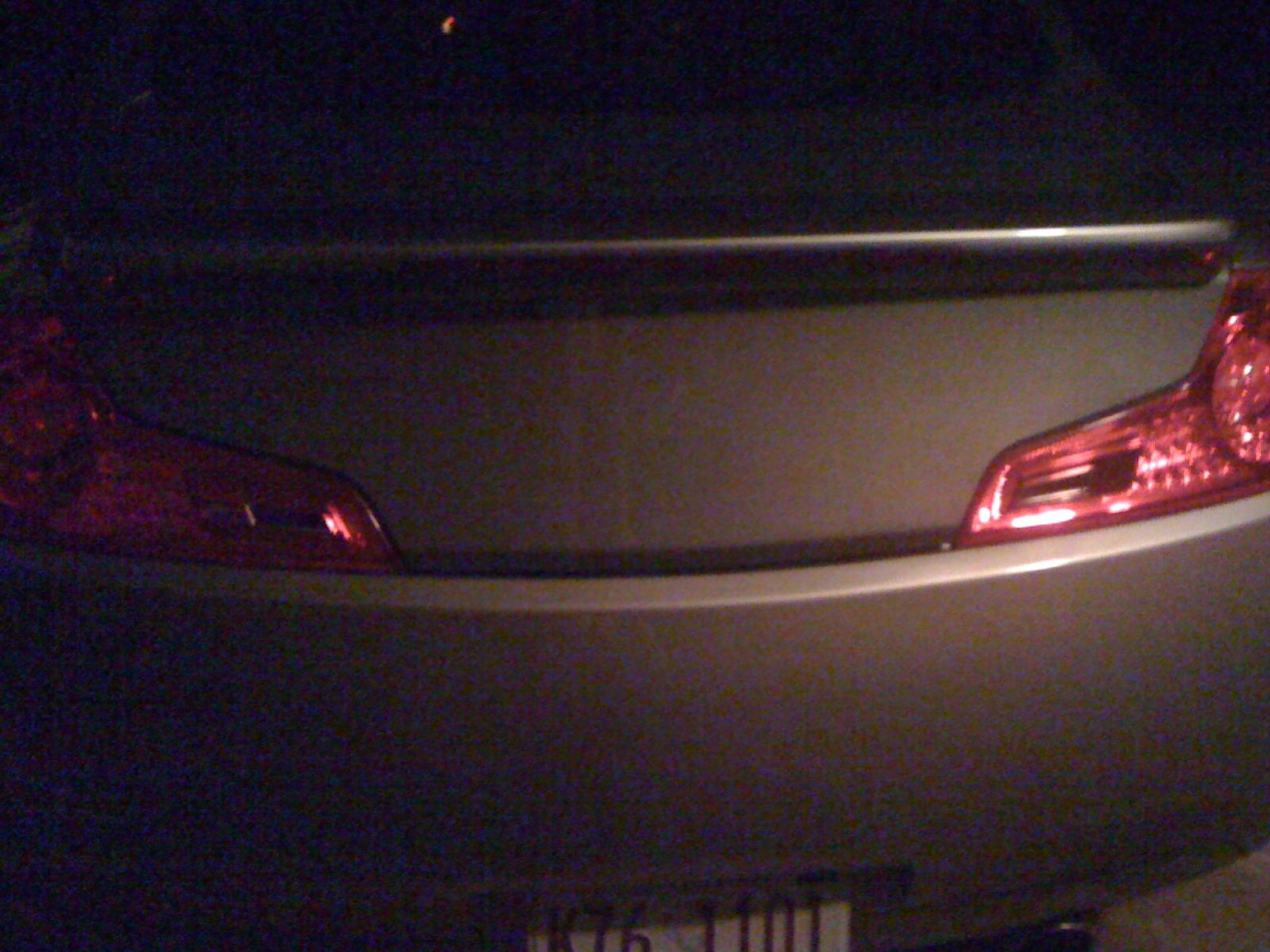

^^ haha thats what i want. im just about done. gonna have it buffed out tom. i got a mini scratch on it (^%$%$%&) haha but i already like the clean look much better.

started outside when it was a lil light out. finished in the garage once it was dark haha gonna buff it out tom morning hopefully and post a better pic. Thanks to Konxeptionz and Gary for the help. always appreciated
