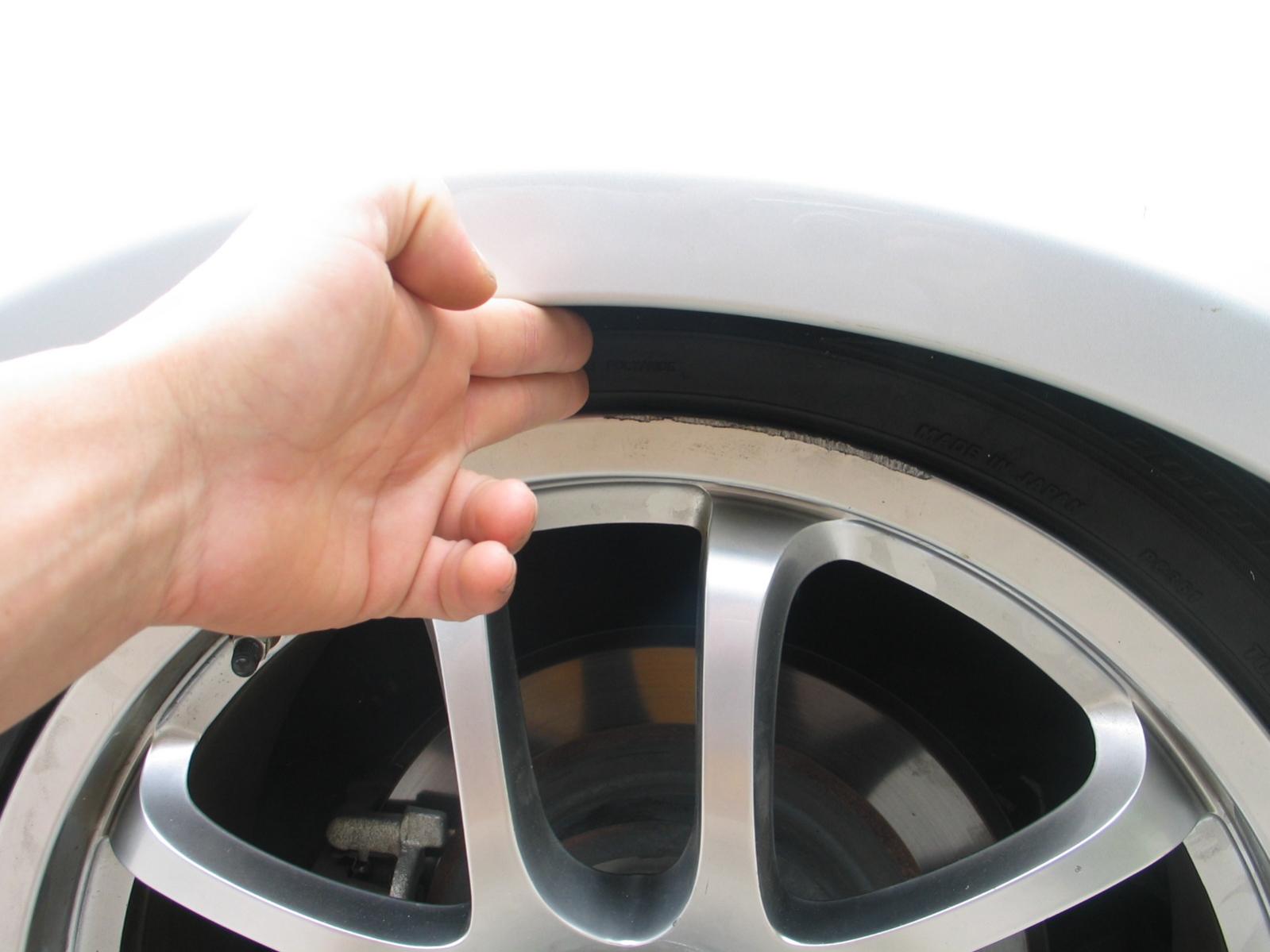

okay.....someone with bc coilovers please help me out here. How low are you in the rears? right now I'm 1" lowered but want to go up more. I know I don't have enough thread on the springs to get to stock height but I just want to be 1/2" lowered> I don't even think i have enough threads for that. Does that sound correct? any help is much appreciated....

so I guess they make short springs and longer springs for the rears. I have the short springs. right now I am super tucked in the rear lol

some shots
Attached Thumbnails bc coilover help!-172_7207.jpg   bc coilover help!-171_7199.jpg

take a pic of the spring setup, that shouldn't be near the highest the setup can go.
