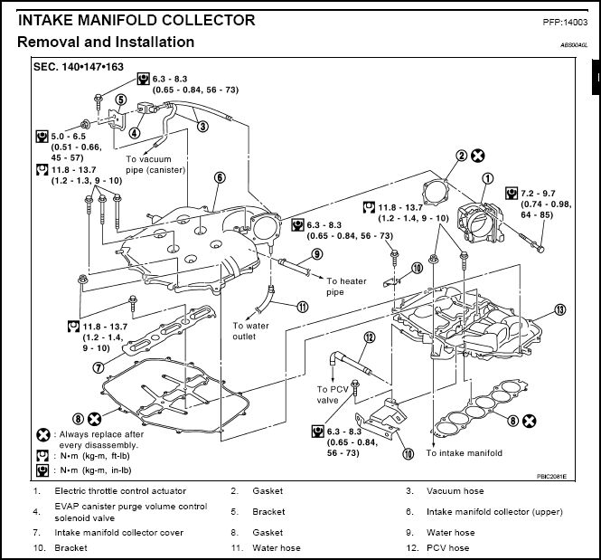

Originally Posted by bina12834
do you know where the TB heater line is located? I followed the directions that Motordyne sent to a T.
TB is Throttle Body. There's two small coolant hoses connected to the upper collector (plenum) right behind where the TB attaches to it. You would have needed to disconnect these if you completely removed the upper plenum or if you installed the MD Iso-Thermal TB gasket instead of the shut-off valve. Their purpose is to heat the TB and prevent icing on the plate. See the diagram... items 9 and 11 represent the hoses and their connection...
11 is the hose that the MD manual shut-off valve would have been intalled in.
Tony's manual doesn't actually call for disconnecting them unless you installed the Iso-Copper gasket which has it's own coolant connections that replace those on the plenum.
Either way, if there's no leak and your coolant isn't low you probably just need to burp the system.
Does this help?

i did disconnect those hoses because i took the upper plenum all the way off. Im pretty sure i reconnected them correctly though. Ill have to recheck my coolant levels. I figure the car would overheat if they were low, and the car hasnt overheated yet.
