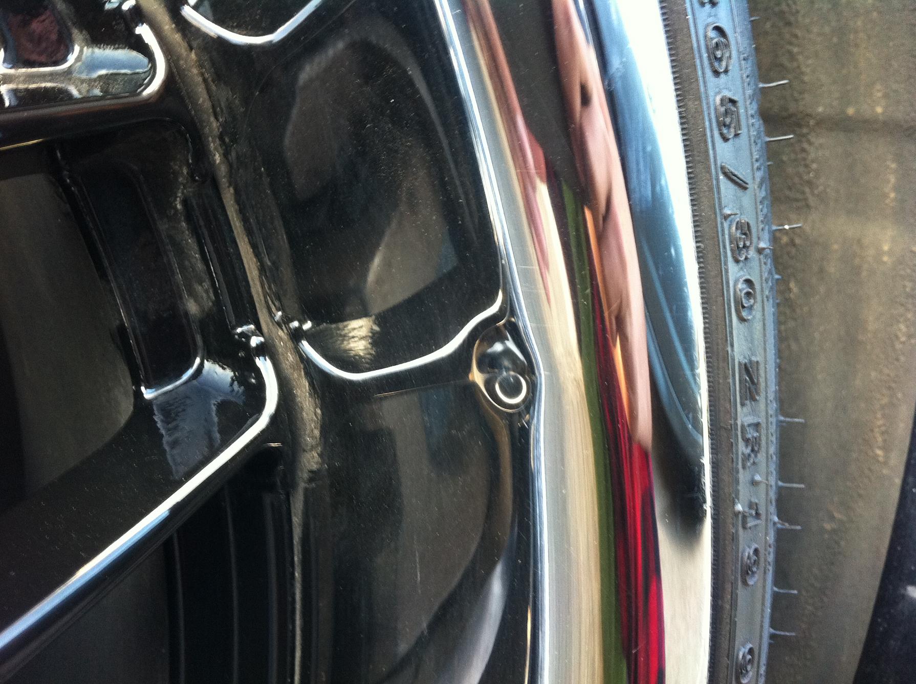

Well not entirely to sure about the rim, the rear rims have dents around the outer part of the rim, i keep getting told different things, the camer needs to be fixed, or i should go from low pros to medium pros, and even that i have cheap rims.
Old Apr 6, 2011 | 09:19 PM
4D05G35's Avatar
Joined: Dec 2009
Posts: 1,651
Likes: 50
From: WA
Such as curb marks?
Have you hit any curbs?
I cant think of a single rim (even the cheapest of the cheap) that would bend in a week under normal driving conditions.
Post the details of your wheels, tires, and camber.

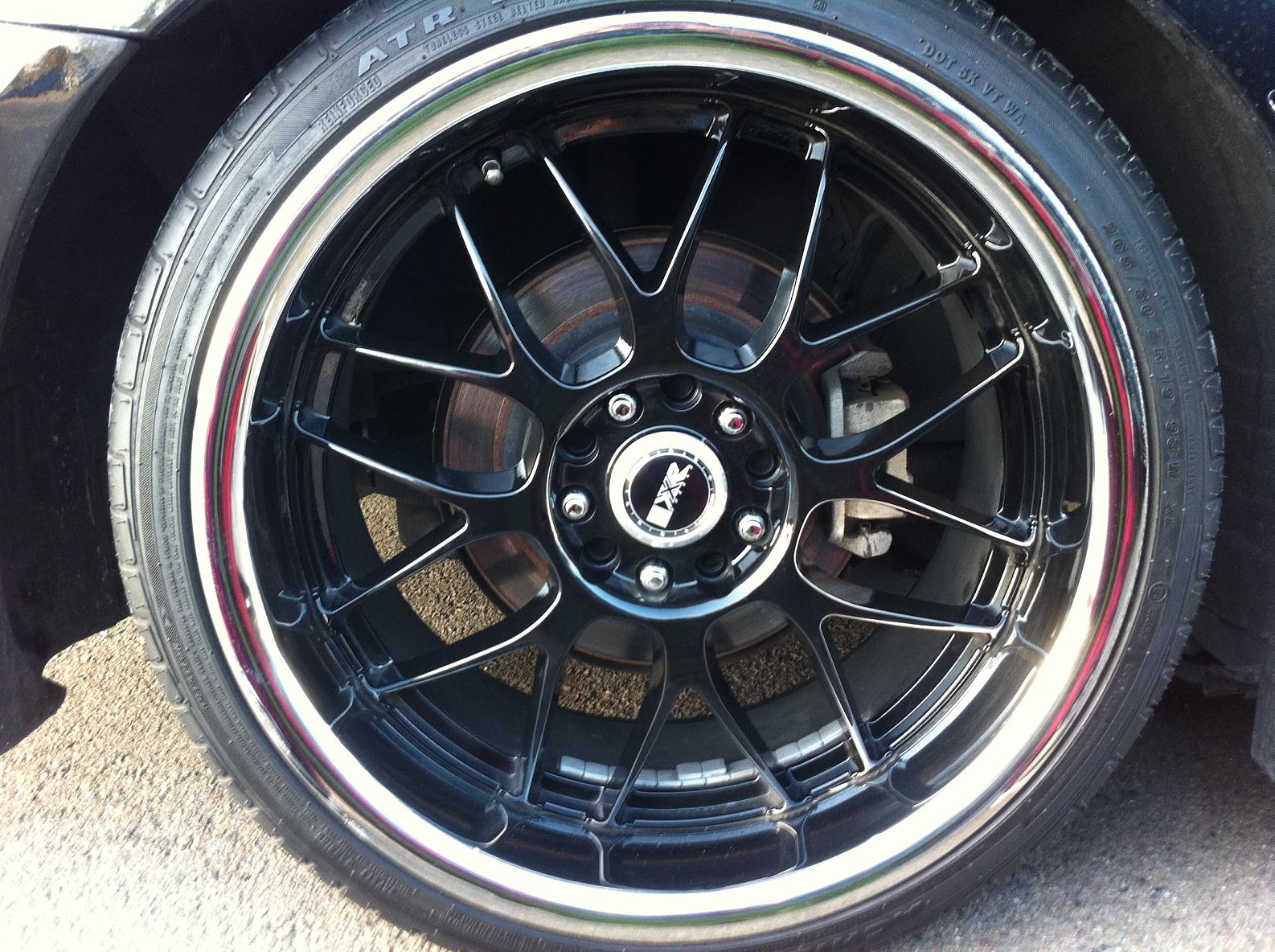

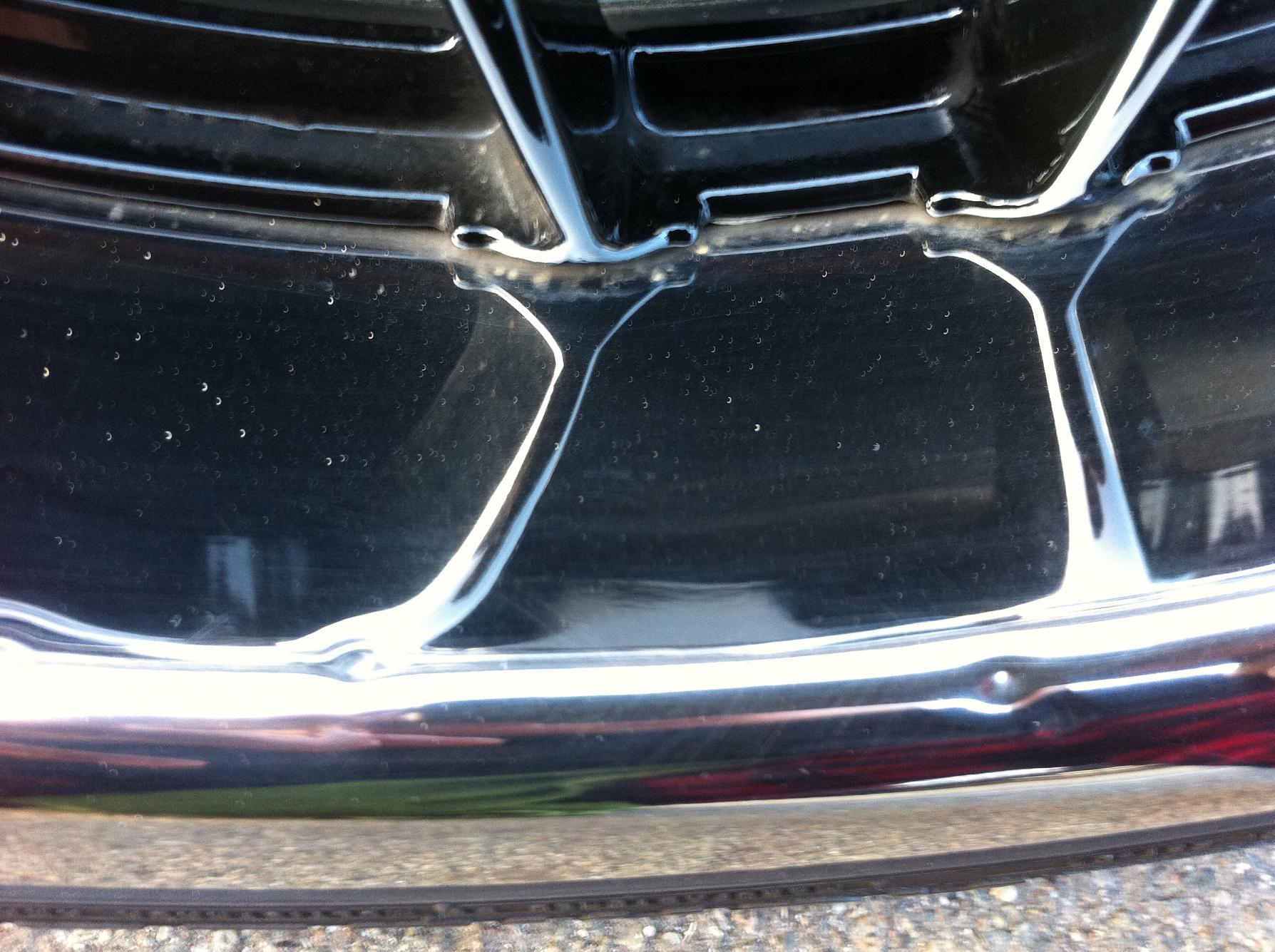

Front Tires - 235/35 ZR19 91W
Rear Tires - 265/30 ZR19 93W
Attached Thumbnails New Owner, Help Needed.-img_3125.jpg   New Owner, Help Needed.-img_3127.jpg   New Owner, Help Needed.-img_3129.jpg

Old Apr 6, 2011 | 09:49 PM
4D05G35's Avatar
Joined: Dec 2009
Posts: 1,651
Likes: 50
From: WA
Those arnt bends in the rim, they are knicks. They look odd. Do you have any enemys because those dents look intentional and not something road debris would cause.
Old Apr 6, 2011 | 09:52 PM
MarcWar's Avatar
Joined: Apr 2011
Posts: 25
*sigh*
What a relief to know they arent bends. Thank you for that, and no i dont have any enemys, i would know that for sure. Any idea on what it could be?

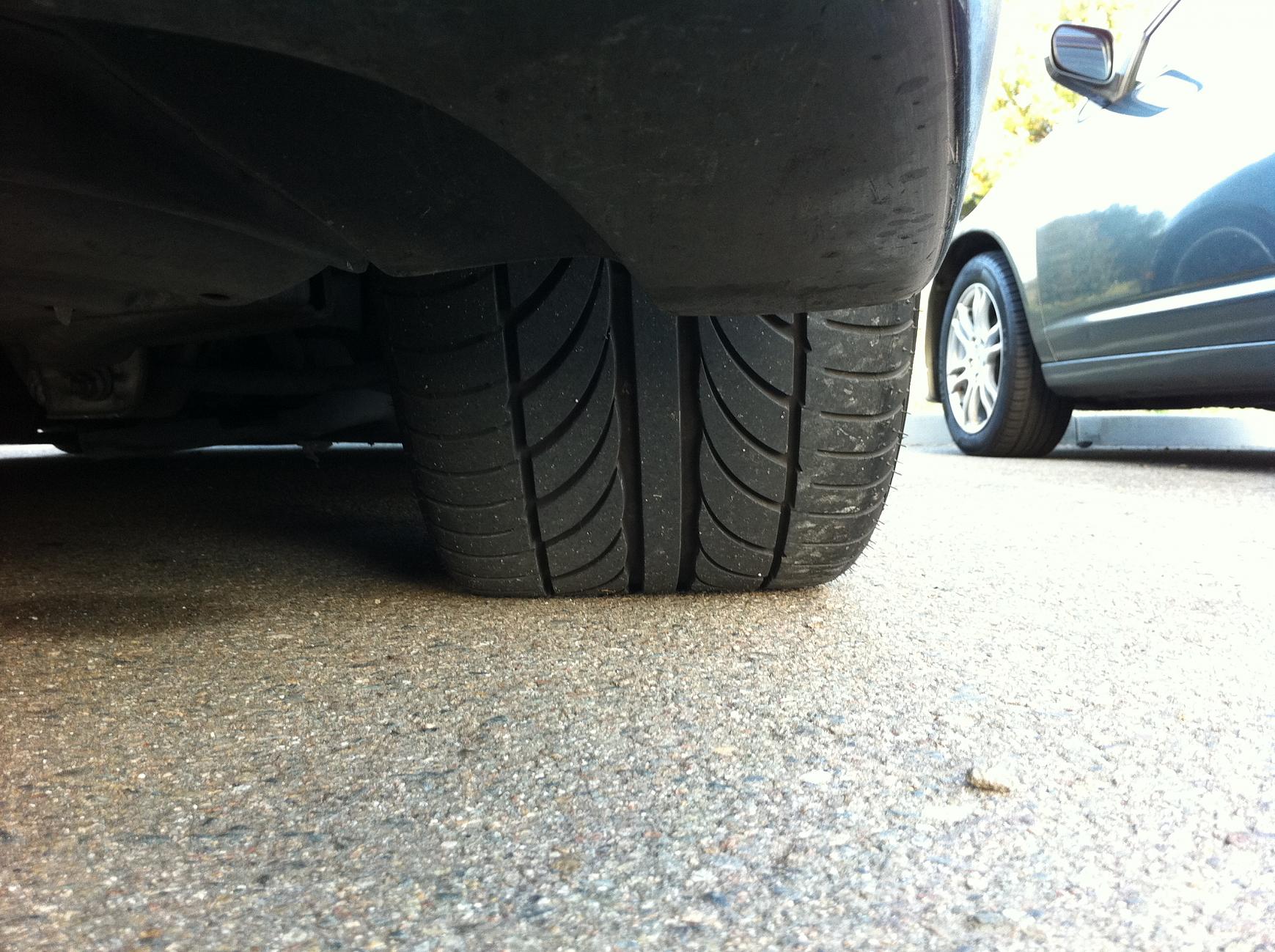

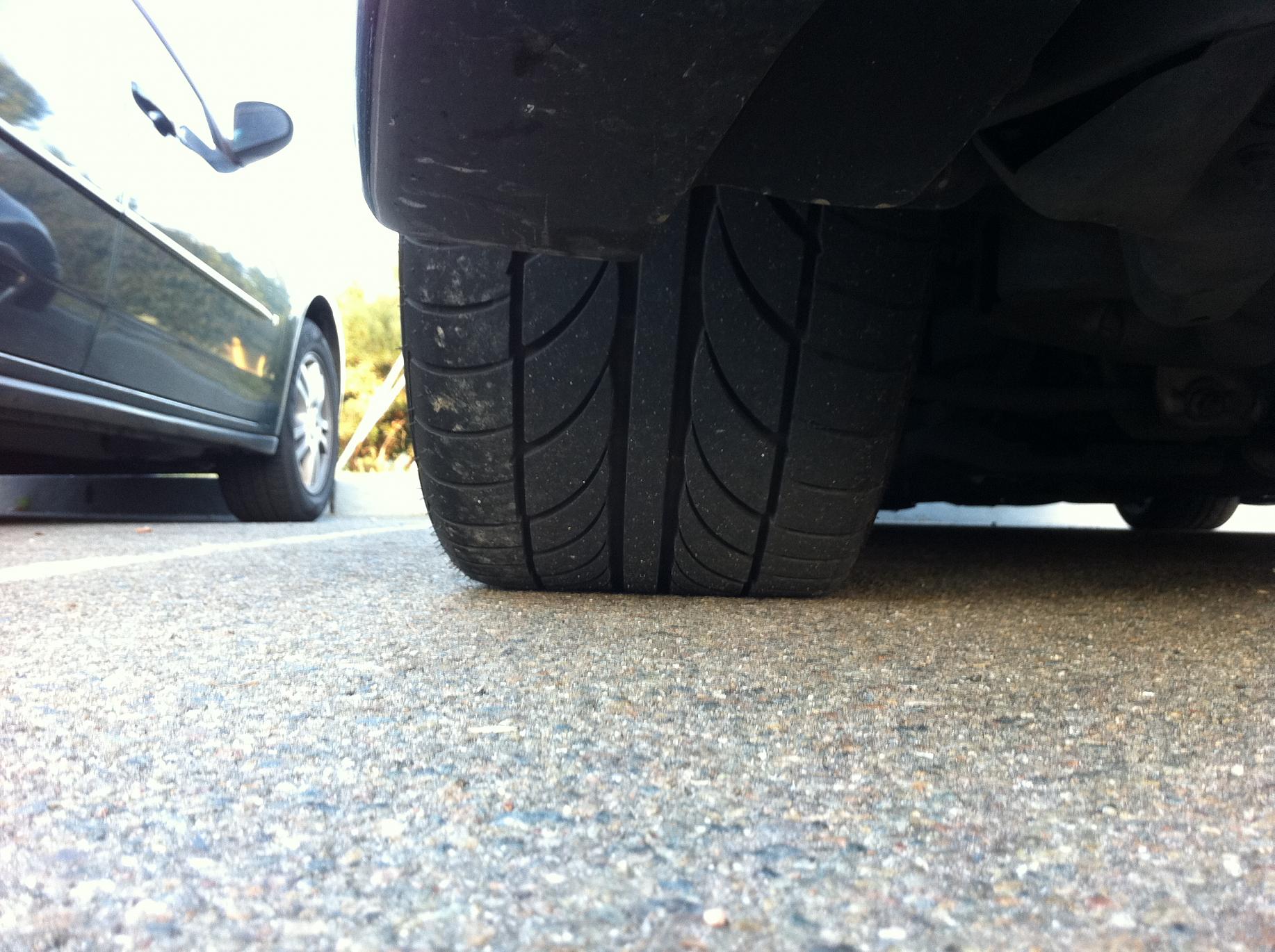

Im also going to post up pictures on the rear wheels showing how bad the camber is.
Old Apr 6, 2011 | 09:54 PM
MarcWar's Avatar
Joined: Apr 2011
Posts: 25
Is the camber suppose to be this noticeable, i really need a camber kit. :/ And this was with the camera lying flat on the floor.
Attached Thumbnails New Owner, Help Needed.-img_3131.jpg   New Owner, Help Needed.-img_3130.jpg
