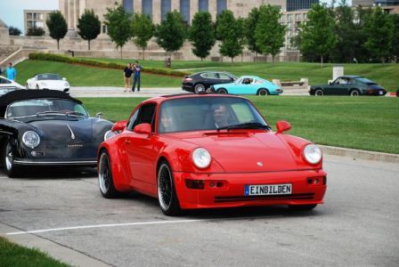

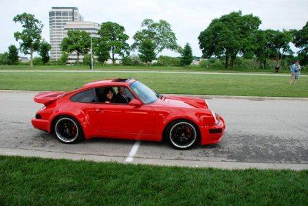

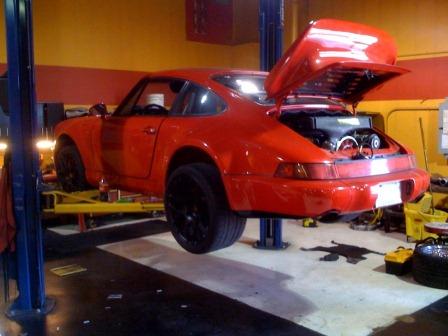

Here is my on going project...
94 turbo, Pauter Rods, .5 bump in CR, One of my turbos, headers, tial wastegate HKS EVC 5, Custom cams, ported heads, RSR valves, CNC cambers, ceramic coated the pistons, dry lubed the skirts and rod, knife edged crank, ARP headstuds, IPX ignition, I welded a bigger core on the stock intercooler, modified the fuel head and punched the WUR, Euro injectors and lines. H&R coilovers, Turbo S tail and front chin, S brake ducts. If you know anything about Porsches the 95 models changed a little so we welded in the front cowl and wiper system, put 993 windows in it and converted it to AWD and put the 993TT 6 speed in it.
Put down 453 on my Mustang dyno to the wheels. She’s a little stretched on fuel at 1.1 bar so I am playing with the fuel system again and or going to run meth injection. If I get really bored I will switch it over to Autronics

i love 993! hopefully I can get my own in 2 years =D

That's a 964 Turbo even though it's a 1994 and they started making 993s in late 93. The Turbo 993 did not come out until late 94 as a 1995 model :-)
