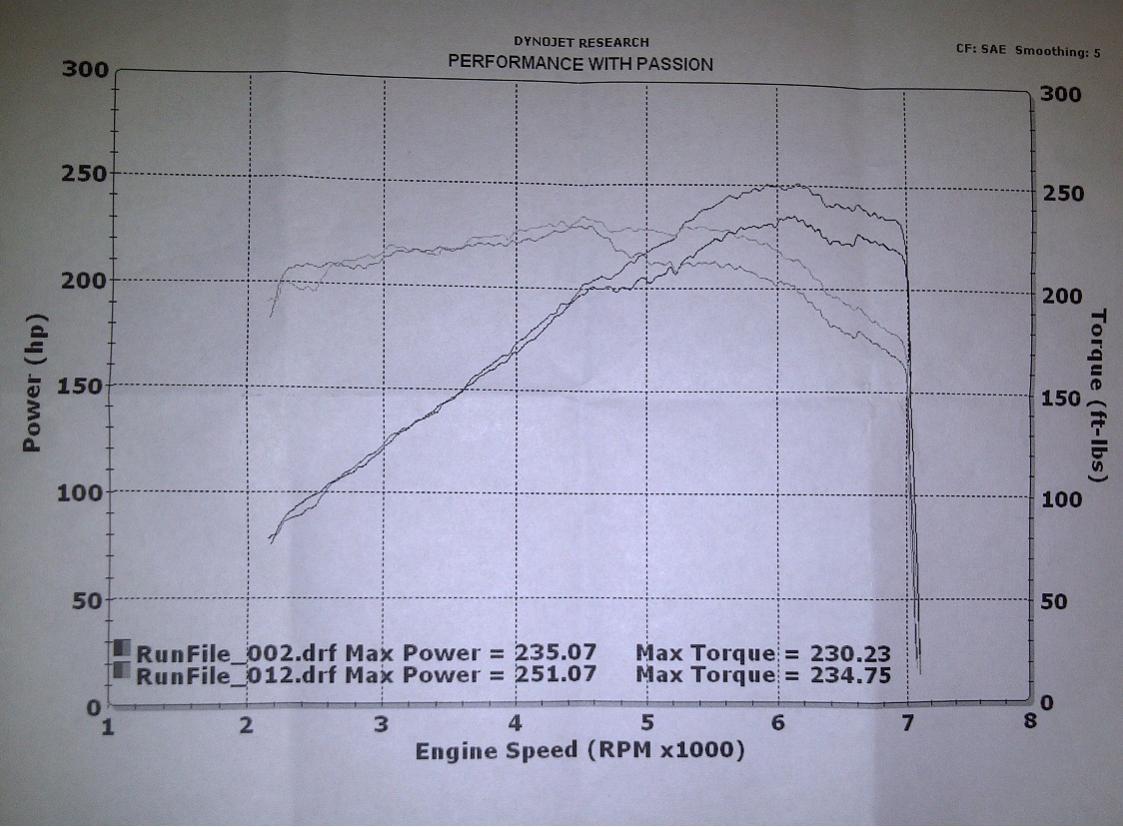

Check this out for example, it would be better for this guy to shift at 5500-6000 rpm when racing
Most high-revving motors make peak horsepower a few HUNDRED RPM before redline (not a few thousand). For example, my 04 coupe is rated to make peak at 6200, redline at 6500. A rev-up like the OP's is rated to make peak at 6400, redline at 7000. And, just for the heck of it, the new E9X M3 with the V8 makes peak power at 8300 with redline at 8400. The M5 on my driveway makes peak at 7750 with redline at 8250.
Anyway...when driving your car the point is to maximize the amount of power that makes it to the wheels. With each higher gear, less power is translated because you lose the mechanical advantage gear reduction with each higher gear. So, unless your car drops in power significantly at upper RPM's, there's no reason not to rev it to redline.
Look at the graph you posted. You wanted to maximize the power under the HP curve. If you take a 1500RPM band, you'll see you get the most power under that 1500RPM band if you make it so the upper end of that band is at redline (5000-6500). If you instead shifted at 5500 like you suggested, the bottom portion of your band would be 4000 and be seriously out of the power band.
Granted, some times vehicles have a much higher redline to allow overrev where you rev the engine a bit higher than your typical shift point because you need to brake anyway and an upshift followed by an immediate downshift would actually waste time and slow you down.
I understand all these concepts however everything has exceptions. With my civic's in the past I always shifted 100rpm before the rev limiter as the power was there. However in my G35 when you have a race where I'm shifting at 7000rpm and no longer pulling away from buddy after 6600rpm......its obvious that I will keep losing. For the hell of it I shifted at 6500 that time racing and guess what...I kept pulling hard away from him and gaining car lengths...you would have to be retarded to keep shifting where you're losing races.

There could be a ton of reasons why you're benefiting from short shifting. Something is causing your power to drop off hard enough that shifting to the next gear is actually resulting in more power transfer to the ground than letting it wind out. Could be anywhere from bad gas causing the engine to really pull timing to a dirty air filter or even a bad spark plug in one of the cylinders causing it to miss up top.
Here's mine
Whenever I turn vdc off shifting at 7k = lots of tire spin when I enter 2nd.
Maybe I shift slow but I find it better to shift at 6700 to 6800ish.
From 2nd to 3rd, 7000rpm still spins a little bit, so I still think 6700 to 6800ish is best shift point.
If you hit the rev limiter, that'll slow you down even more... So I'd say 6700-6800ish in my opinion.

I think your plan to get 20 or so runs in is ideal. But may I make a suggestion?
5 runs at 7000, 5 runs at 6500, 1 run each at 6500, 6600, 6700, 6800, 69(teehee)00, 7000. Then 7000, 69(Ha-Ha)00, 6800, 6700, 6600, 6500.
I think you might get the best times in the 6900 to 6800 range, shifting exactly as you do. I drive an 07, 6mt, and the rev limiter and I are not intimate, but we know each other well. I think you'll get the best shifts at the top end if you scale back just a bit, not a full 500rpm.
Worth some thought anyway.
OP, this is what I'd be thinking about. Looking at the curves posted by lcysimon, you can see max power at max rpms. I've always noticed a delay in RPM drop after letting the gas off. Its very possible that you are shifting well, in time, and with great speed, but the engine is touching the rev limit, or responding a little slower at the top end, due to the above reasons, or even due to design.

Let off the throttle at your 7k shifts.. You might be hitting the limiter shifting at 6,800 is about right of you're shifting WOT. I didn't notice it myself until I had a camera mount and recorded a few drag run.
So what you should try is to get a camera and see if you can do a few pulls with the window up to eliminate wind noise.. You'll be able to hear if you hit the limiter.. I cut my shifts back from 7-7,200 to 6,800 with a faster time because of this. Also shifting while letting throttle fall was almost the same time as shifting WOT at 7k.
Car was stock was I was doing this sub 10k miles.. Yes I shift fast enough.. too bad you'll have to take my word for it.
As for the power curve thing.. This is directed at the OP's 2006 6MT and 05+ 6MT ONLY this does NOT apply to 03-04 G35s and does not apply to automatics of all year.
We've actually pushed the power curve upward of 7,200 before on stock cams by adjusting the intake manifold.. giving it more volume. We saw a very very big drop in power curve by doing that. What is proven and is very popular today is to actually use longer an intake manifold with longer runners but increase the volume of the manifold. The result was an astonishing jump in mid-range especially in the entire torque band. With more power BUT ALSO PEAKING OUT at 6,000.. (stock would peak and hold from about 6,400-7k).. so with this mod you'd wana shift right at 6,100 and just run that peak..
