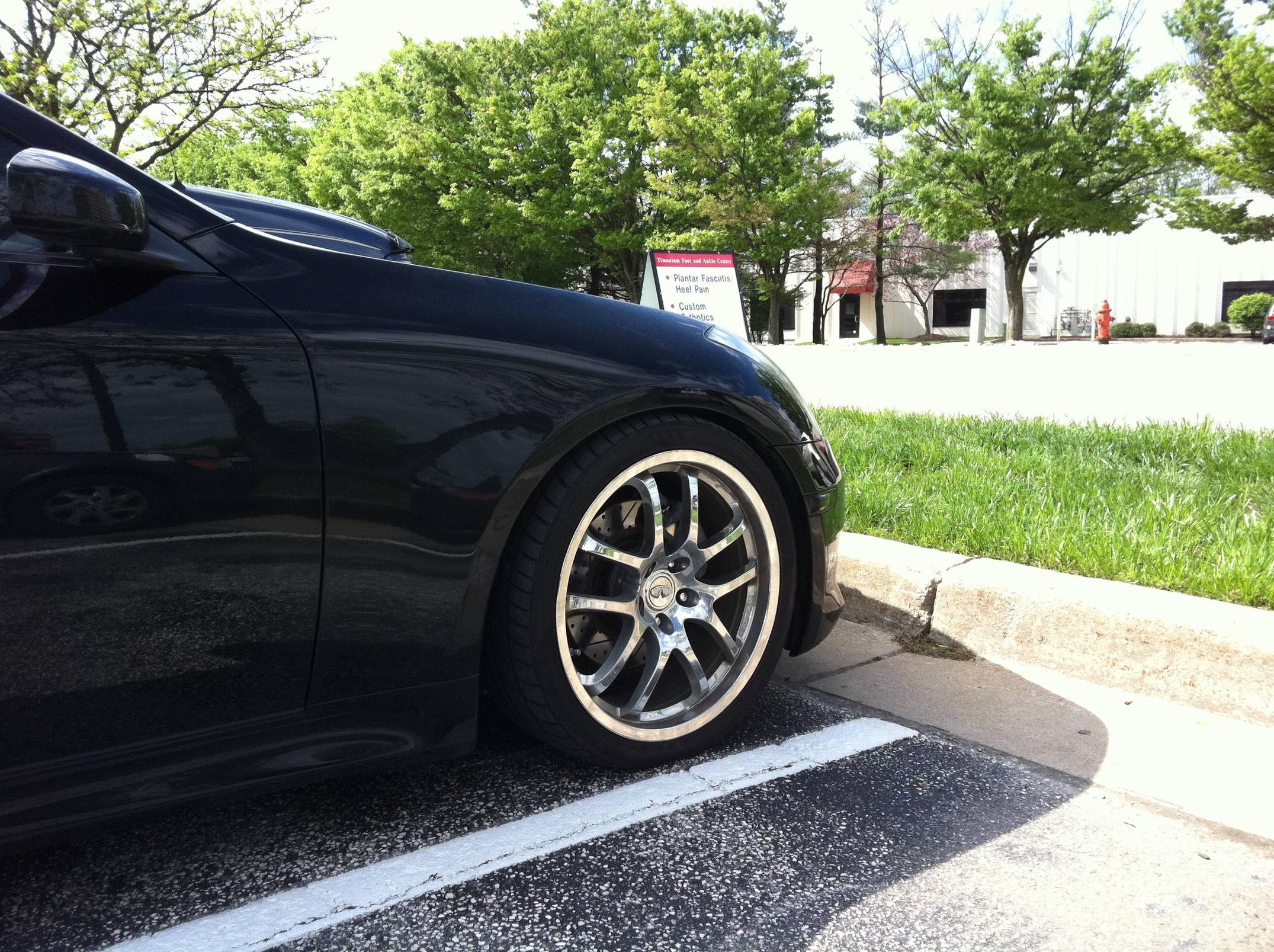

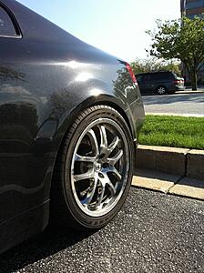

I have the HR Sport with D-Spec shock combo... mine didn't require any settling. Something definitely looks way off.
Here's mine after only about 4 hours of the install:
These springs give a perfect drop, as long as you're not trying to be slammed, and the ride is still great.

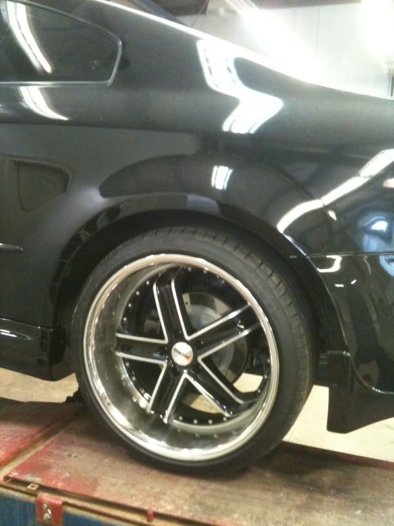

Originally Posted by G35INTHE260
So the Body shop that is installing my
After H&R Sport Springs
WTF! Thats AFTER the install?? Something is definitely wrong there.
See if you can get some pics of the install.

First of all in that pic^^ it doesn't look like the back end is sitting completely on the ground, the tire doesn't seem compressed enough.
Second make sure the shop seated the rubber piece/spring properly in the bottom of the spring bucket and the same for the spring mount up top on the rear wheels. If the springs aren't lined up properly with the grooves it could cause the car to sit too high, and would be dangerous for driving.
Exactly, that's why I asked the OP for pics of the install but it doesn't seem like he cares to get them.... w/e I guess, not my car/life.

Its the weekend lol the shop is closed. Believe me I am chomping at the bit to try and get in there and take pics and overlook things.
I noticed the same thing that it looked like the car wasnt sitting flat like there is a jack behind where u cant see or something. I swear thats what it looks like.
