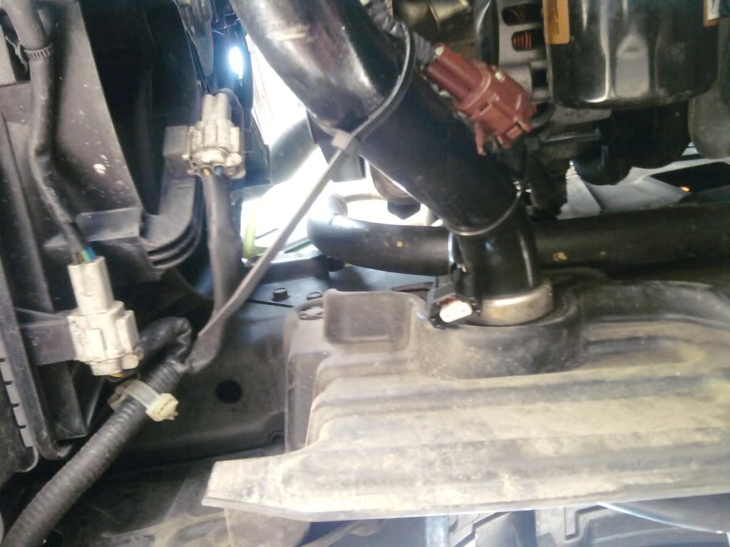

took my bumper off to see how badly damaged or clogged my radiator...here it is

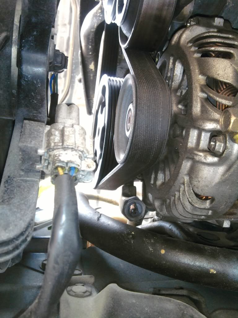

got under the car and this is what I found.... As you can see, right above the hose, there is a connector that is broken. What is that connector for?
Edit: tried to unscrew that bolt from the top. As soon as I've loosened it up a bit, oil started to drip. So my guess, is that its a sensor that has something to do with oil.
And of course, this is the socket that goes into it.
Where can I get this connector and can anyone tell me what is it for? Thank you!
That looks like the power steering pressure sensor.
THank you! I will ask a dealer about it, see what they will say.
+1 for you K67p67...it is power steering pressure sensor. Wend to a dealer and thats exactly what they said it was. The kicker is that in order to fix it, the part will cost me $350 for the whole unit, because they don't sell just that sensor!
