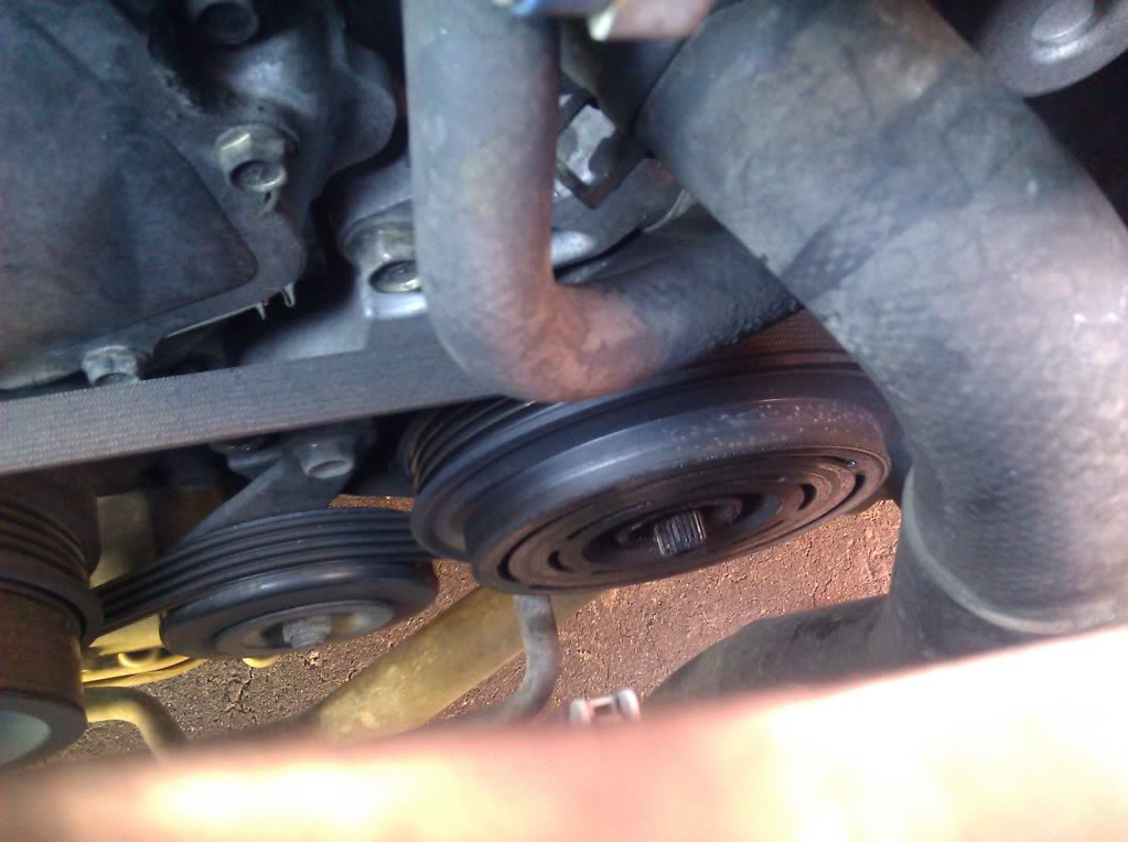

I've been looking everywhere in this site for help with my A/C problem. the other day my A/C stop being cold and i don't know why so i took it to a shop and they pointed something out to me. The clutch on my compressor is broken off.
can someone please help me. Tell me how do i fix this or what should i do?

I have the same problem now, my clutch fell off but I have the part, can this be fixed

Mine fell off as well the bolt was stripped when it came off. The shaft won't turn. So now I have to replace the compressor. You may have too as well. Take my advice go to auto zone or advanced or even O'Reilly to get a compressor. It will come with clutch included. 304$-372$ Once I get the money for mine I'll hit up a small shop and have them do it.

yea for now i just cut my belt off since the clutch messed it up anyways , i will decide what im doing soon as well
