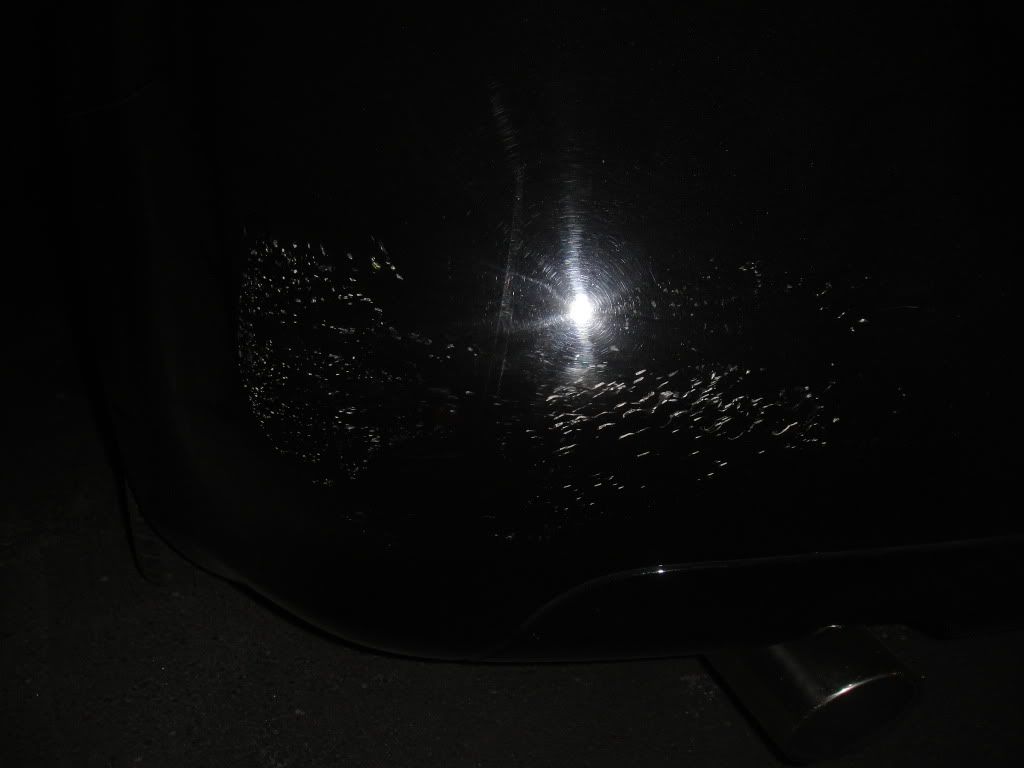

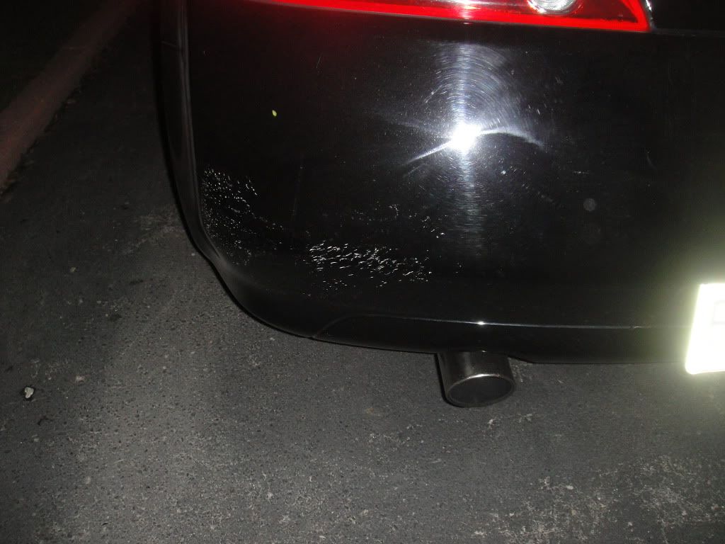

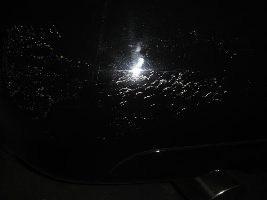

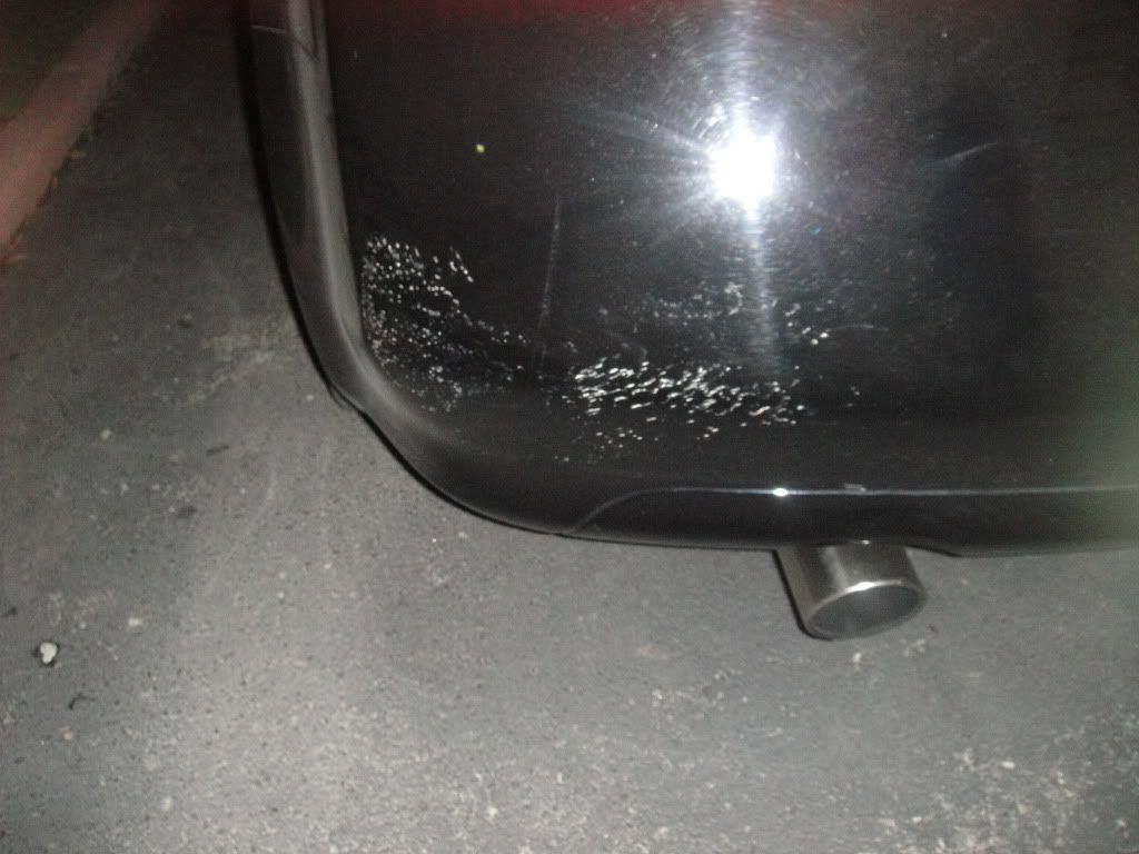

Hi,
I scratched my car on the bottom left side of the rear bumper.
It doesn't look too significant to me but its definitely not just a minor scratch.
Luckily, there's no dents.
I've attached some pictures so you have a better idea of what it looks like.
Can anyone please recommend the best solutions to get this fixed (both low-cost and high-cost options)?
Thanks.

not much you can do but paint it....

So, does that mean I would just have to go to a body shop for paint?
And wouldn't painting just part of the bumper be noticeable?
Will a cheap alternative of scratch remover kits or touch up pens work?
I don't mind painting it but I just don't know where to start or go to get it done.

I can't really tell but if the paint is completely gone in some areas, you'll have to get the whole thing repainted.
Either that, or you can go with a touchup paint, prep it perfectly, sand it down, and then polish the crap out of it. If it's just clear coat scratched up, just get a compound and polish it away.

Replace the bumper just because of a few scratches........seriously? Before you put out $300 to have your bumper repainted (done right the whole bumper s/b repainted) Depending on how many and deep those scratches are I'd have the area hit with a high speed buffer and compound at your local detail shop/car wash. Depending on the results you could order touch up paint from Dr.Colorchip and finish the job yourself.

Why not? if you can get a nice clean original bumper with the original paint for a good price and install it yourself. Those starches look bad don't look like it's a job that retailer can easily fix.

OP, what did you hit? Those are odd looking scratches...

lol. Honestly, listen to Gary and your life will be simple. Getting a bumper replacement might seem simple enough, but the cost is usually not worth it when compared to simply doing a repair that involves nothing more than buffing over some starched clearcoat.
