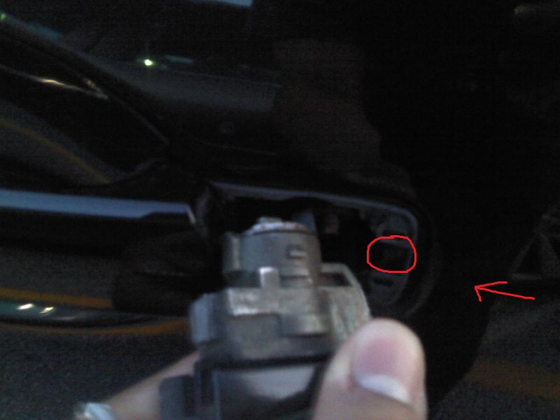

This happened on my passenger side and im assuming its the same on the driver side. I circled where the screw was on mine, and the arrow is where you should put your screw driver in to screw in the screw.
Driver's door lock/escutcheon coming out.. fix?-vd9ql.jpg

Thanks, I'll take a look to see if the torx bolt is missing!
