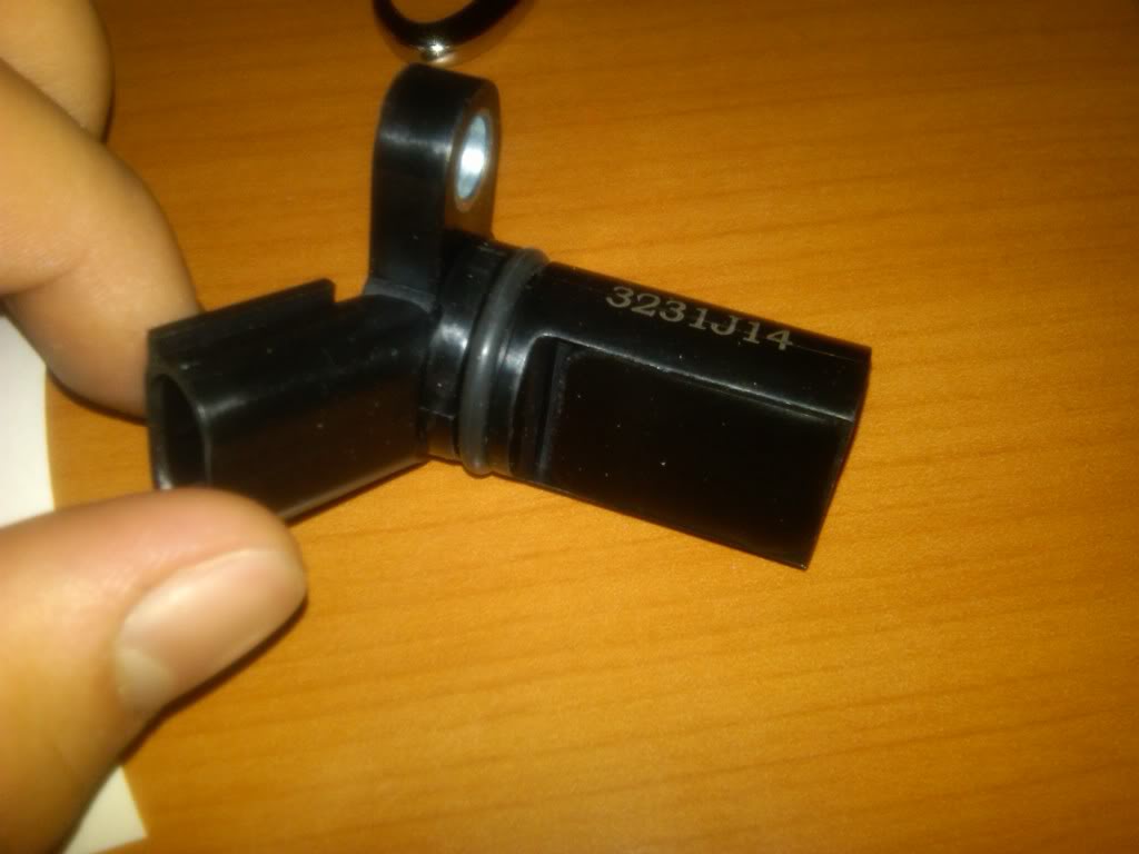

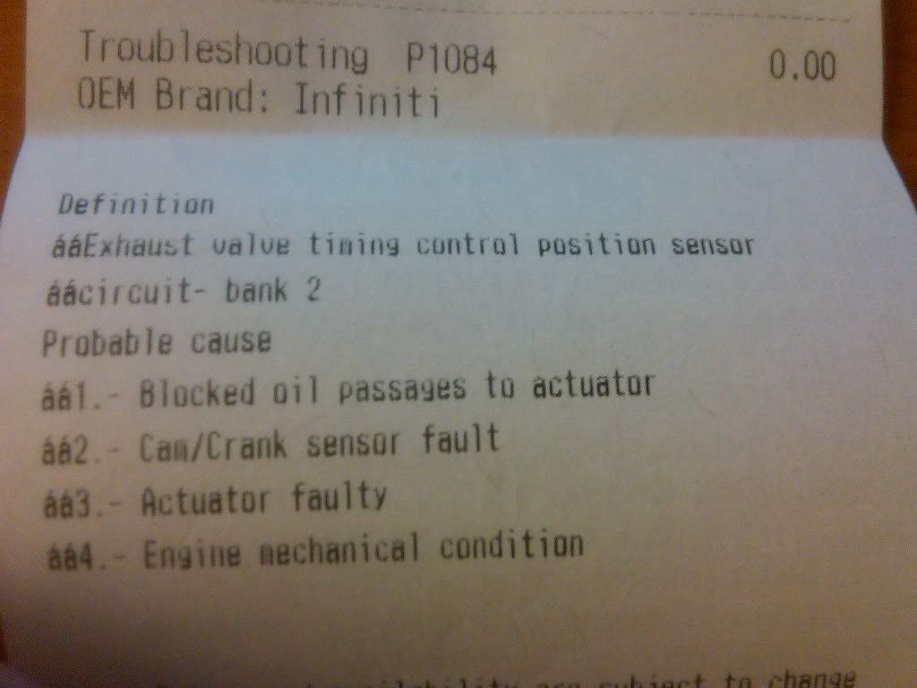

Hey everyone! Fairly new to this forum but w.e. Got my 05' G35 6MT coupe (Lakeshore Slate) a few months ago. My SES light went on and I got Code P1084, its also throwing the high rev code. I feel like every situation is unique and that is why i'm posting mine in a new thread. I have spent hours of searching other threads and did not get a definitive answer. I got a new EVT cam position sensor (Driver's side) which I have a pic of. I am installing it this week and will be getting a tune up. I guess my question is, what do I have to do or which part do I have to change to get rid of that code. Based on what everyone is telling me, it could be an O2 sensor, Cam or crankshaft sensor, solenoid.... I don't know if any of you have run into this before. Input would be appreciated.

replace the bank 2 exhaust valve timing sensor. This is the sensor on the back of the driver side cylinder head closest to the exhaust. Then clear the code and you are good to go my friend. Hope this helps you out.

is that the same sensor I have in the picture?

no that sensor is for bank 1.The sensor that you have in the pic has a 45 degree angle on the plug in and the one that you need is straight.The nissan part number is 23731-6J90B for the sensor that you need..
