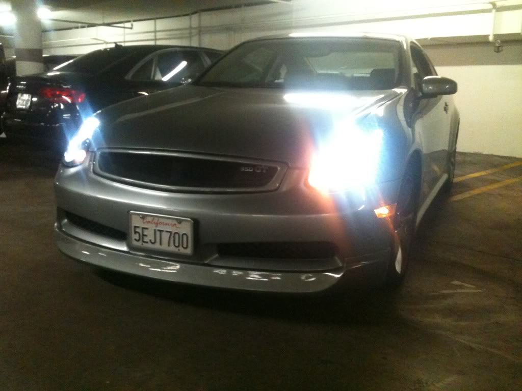

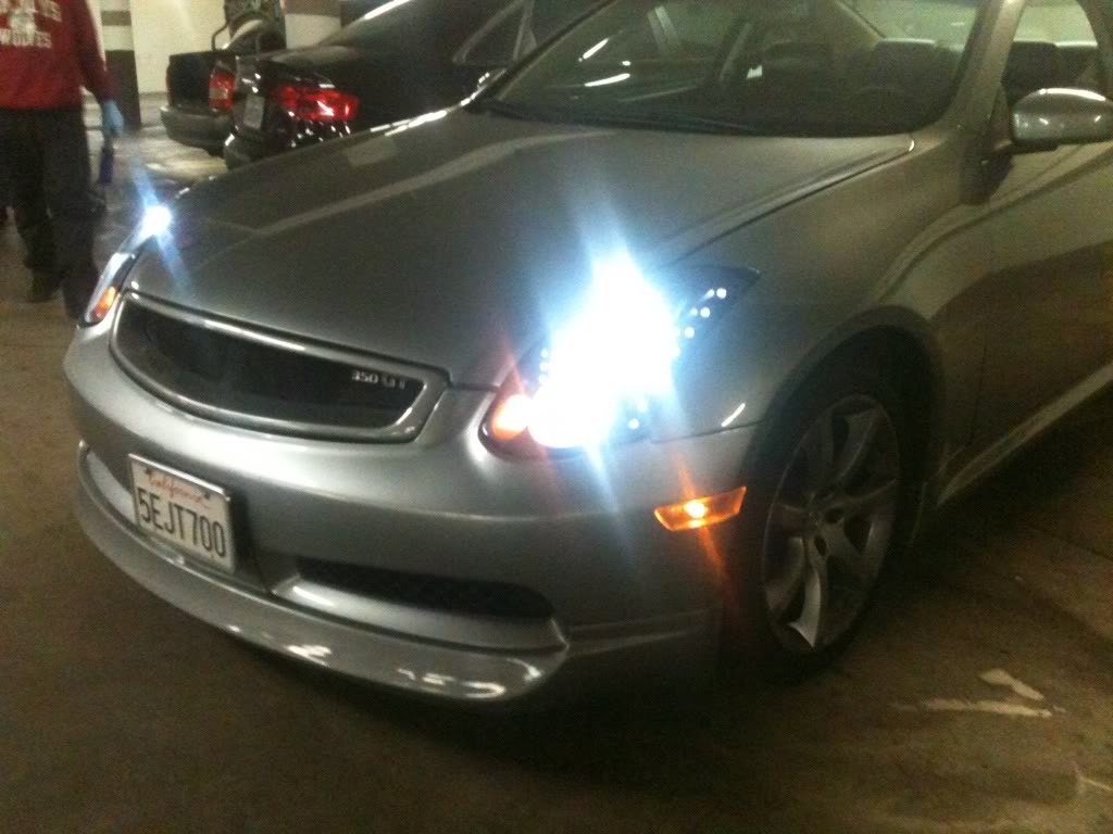

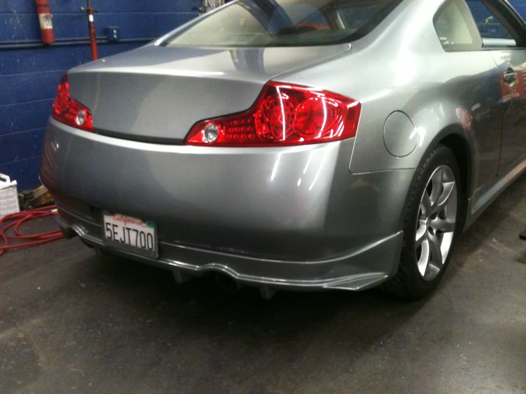

Thank you guys for all your help, I'm going to upload pic of my car and I'll upload a few pic of the look I'm going for with the rims, I got lip kit and I would love to have the wide body look that's why I was thinking of the 1" Spacers. Ok the first car is mine and the second car is one of our own (look I'm going for).

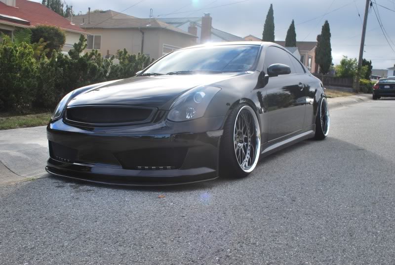

And this is the look I'm trying to get with the rims:

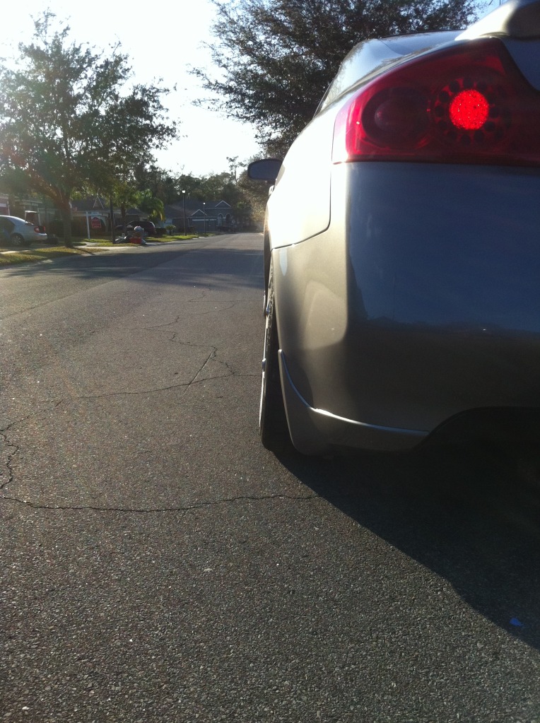

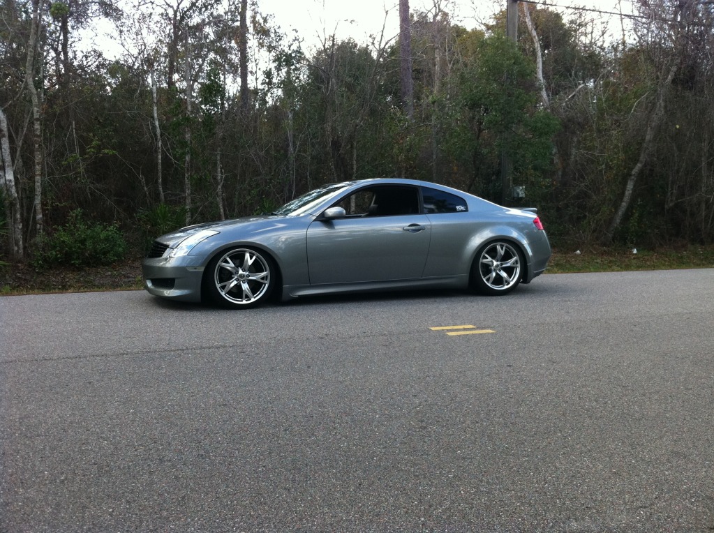

heres my input
theres are
front 19x9 +47 245/35/19 w/20mm spacer
rear 19x10 +30 275/35/19 w/5mm spacer
about 2in drop front and 1 3/4in rear
im gonna get a 25mm (maybe 30) for the front and move that 20 to the rear and add more camber
