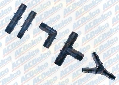

you didn't really say how bad it is, but if either end (the jets and the pump) have usable hose, cut the shredded ends off, then use a 3/16 hose replacement (or whatever it is) and 2 plastic hose connectors.
Dorman makes them really cheap, they look like so:
hey where can you find those plastic pieces mine just broke where it connects to the hose for the washer fluid

^auto parts stores, internet. You can also pick up the hoses there, you just need to know what length you need.
