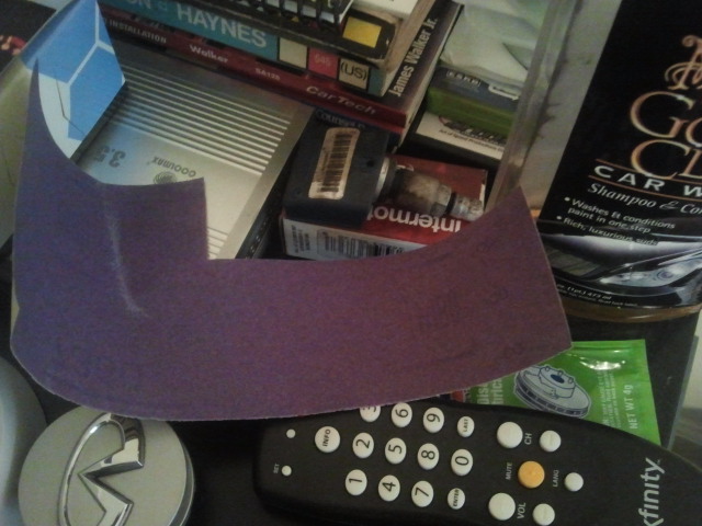

I have an extra one. PM if you want it. You can use these instructions to reprogram if you have a G35 Coupe and you are feeling adventurous.
