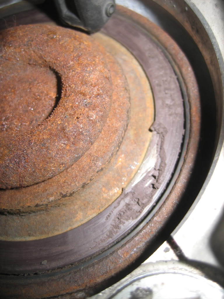

Which wheel bearings were replaced? If it was the front, there is something called a "tone rig" which affects your ABS. Need to make sure that 1) the ring wasn't damaged during the install, and 2) that the ABS sensor has been properly gapped. If not, it could cause some of the ABS issues you are having.
I think you need a mechanic with the right tool to access the speed sensors, he can tell if one is off from the others.
Here's a picture of mine that was damaged by an impatient tech while installing an alignment kit.

Yikes. As far as I know if the tone ring or the sensor was it properly gapped and it's rubbing the ABS will kick on at all speeds. I don't get any ABS light at all. I wil call my mechanic now and ask if he did have it installed correctly. Later on I will put it on a jack and find out if he really did or didn't. If he didn't ill get a reinstall lol. I'll also ask him if my ABS sensor is alright. From what he told me he said the sensor is really sensitive.
