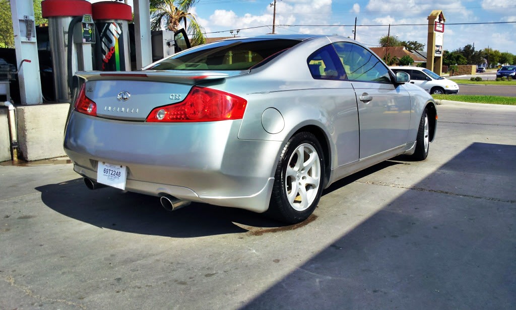

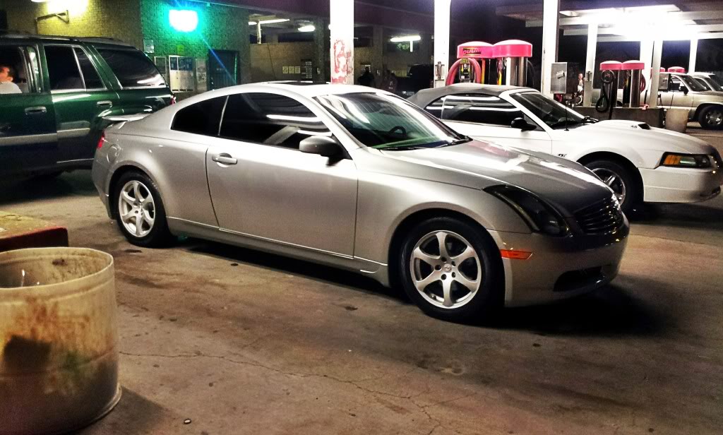

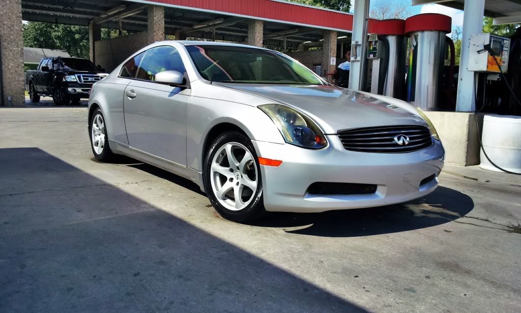

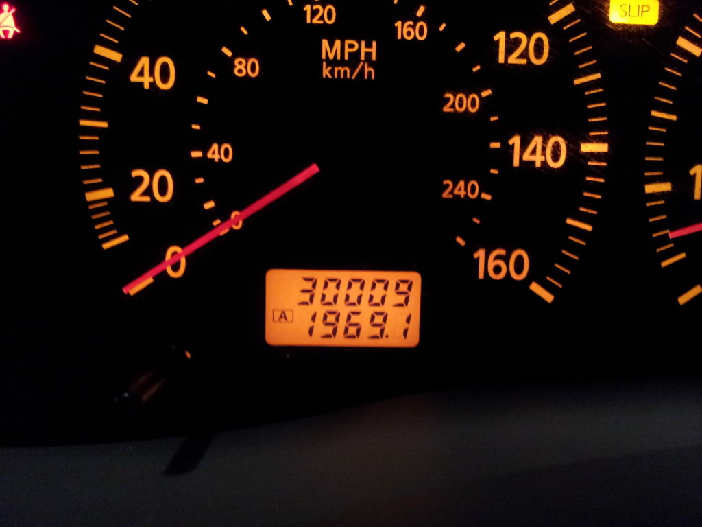

well have about a week and a half with my G its a 2004 g35 coupe i just hit the 30k on it bought it with 29788 miles i belive the car was parked for awhile was in a small fender bender from what i can tell i have some small issues that i need to look into my vdc light is on wont turn off as well as my slip and ses light. i scanned the cars ecu and the codes it read were large vacum leak bank 1 amd 2 and either crank or cam positioning censor is out the car runs great except it runs reall really rich the cars cats were removed they were clogged but i plan to put some high flows later on as well today i was driving and my oil light blinked once then that was it i checked oil and it seemed full but when i would start the car i would hear a slight knocking as if it hadnt picked up oil well i put half a qt of oil and seemed to solve the issue. as well when i removed the oil cap some smoke came out is that normal ? sorry for all the questions im just a newb and want to get educated lol car runs strong i dont think theyre major issues but any infor is appreciated other wise than that i LOVE this car price i got it for was 10.5k
well here are some pics

welcome to the forums. You can try replacing the cps sensors. Are those pin stripes along the door? if so, i would remove them because they make the panel gaps on your door look huge.

Looks CLEAN. Remove that dealer sticker on the left side of the trunk, doesn't take much but ur finger nails and some glue remover.
