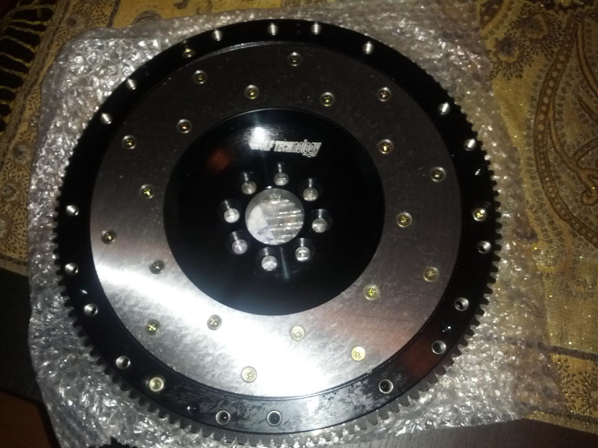

I am in the process trying to figure out if the correct flywheel was sent out to me. I believe the flywheel for my care is supposed to have ridges, not teeth like mine
good thing i took a pic of it before getting installed

Sorry- what year is your car again? Should be easy enough to verify. I'm curious now too-

Hey bud thanks for the info. I have a 2004 6mt coupe. By the way, your flywheel looks a lot different than mine what year etc do u have?
