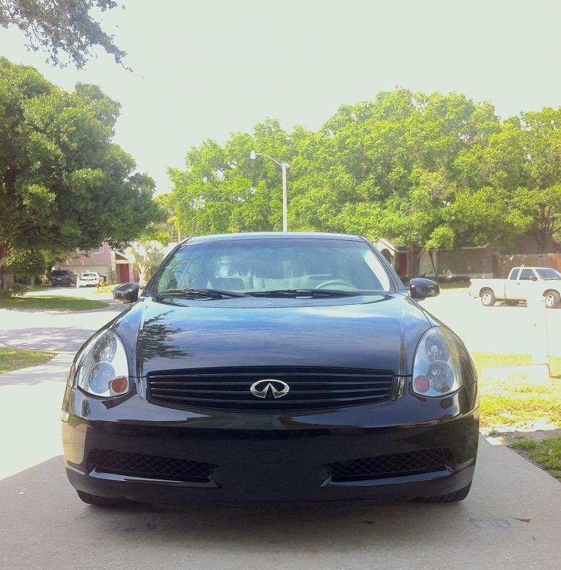

  #26
chaznad's Avatar
Joined: Apr 2013
Posts: 73
From: Florida
05 5AT coupe.. Do i have a sports or base front bumper pic attached
Ive been reading and but i cant seem to figure it out.. i thought it was a base but i have orange stitching on the steering wheel which i read means sport
Old Apr 19, 2013 | 05:17 PM
  #27
Shanes_G's Avatar
Posts: 6,869
Likes: 820
From: virginia beach
Base, sport bumper dident come out till 06
Old Apr 19, 2013 | 05:22 PM
  #28
chaznad's Avatar
Joined: Apr 2013
Posts: 73
From: Florida
oh , well that was easy , thanks
