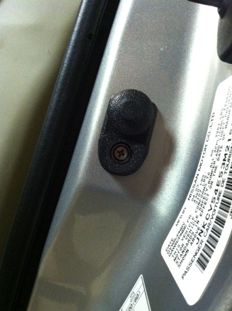

what screw is this? pics?
Old Apr 30, 2013 | 09:41 AM
Macdady's Avatar
Joined: Apr 2013
Posts: 4
From: Concord NC
pic
its the screw right under the switch that operates dome light, pic is of driver side....

I read about it a while back but it's all a little fuzzy now. If I remember right the screw creates the ground that allows the switch to function, so removing it (as tint shops often do) lets them keep the window from automatically moving that fraction of an inch whenever the door is open and keeps the tint from being ruined before it sets.
And by defeating the door trigger you also have all of the other issues in the first post (seat won't move because it thinks the door is closed, dome light and key in ignition sounds likewise). If he hadn't said he'd gotten tinted recently I probably wouldn't have remembered it.
