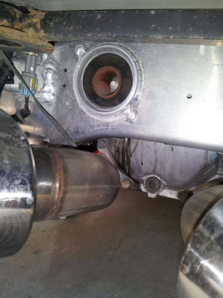

Have you checked to see if your diff bushings are shot? You'll see silicone running down the back of the diff cover if they're bad.

+1 on checking bushings. Thunk noise on launch is typically a mount or bushing.
Check the rear diff bushing first, should be pretty obvious if it failed because it's filled with goo and leaks down the diff cover. I also have a 240SX and that thunk noise can also be bad sub-frame bushings. I don't think the G is old enough to have that problem, and maybe that gooey diff bushing saves the subframe bushings from going bad.
Mine failed recently, here's what it looks like:
