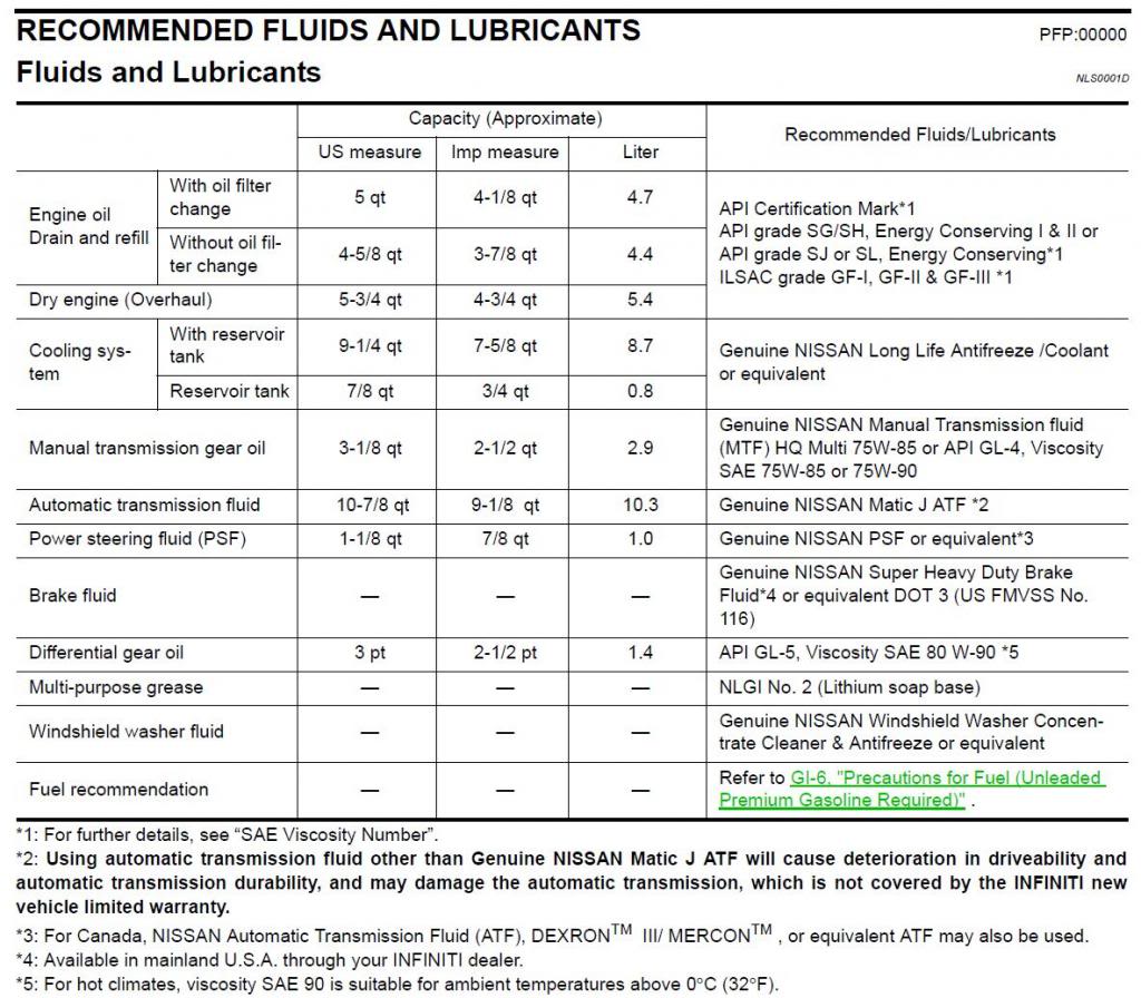

Originally Posted by JKL1031
we can use gl5 in the difff?
Yes, you're supposed to use GL5 in the diff. No additives needed for the limited slip either.
Here, from the FSM
