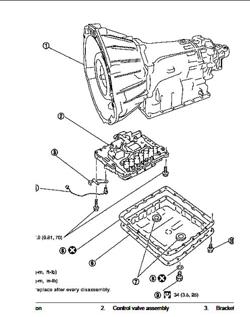

I don't know if you would call it inside the trans as much as bolted to the bottom of the trans. It is item no 2 in the drawing

That is inside the trans
