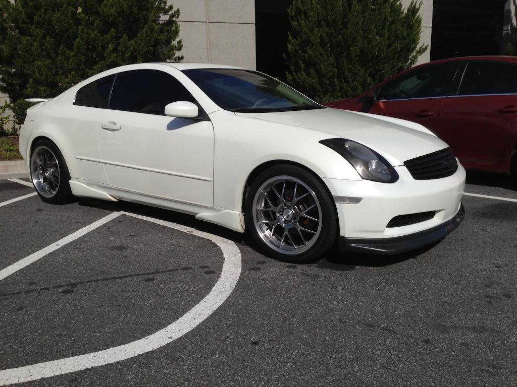

My car by the way

Very clean G for the amount of mileage.
