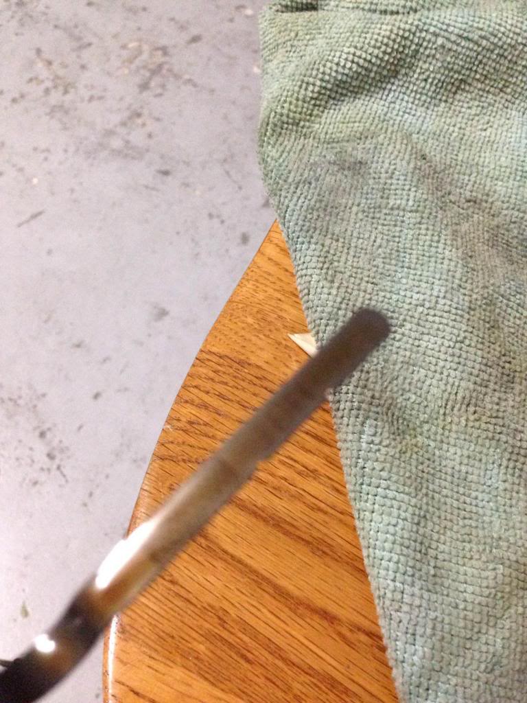

Just checked it right now..It's brown. Doesn't smell burnt
Old Dec 1, 2013 | 12:35 AM
rsingerG35's Avatar
Joined: Mar 2012
Posts: 1,142
Likes: 88
Not horrible, but won't hurt to do a drain and refill a few times.
