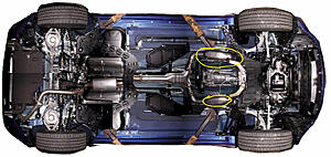

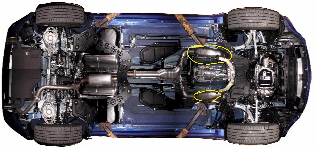

Today I was driving and all of a sudden I hear a grinding sound. Went under to check and this piece underneath was hanging there. I don't know what this part is called so if anyone can help me with that it would be great.
I know this is not a g35 undercarriage but it's basically the same part connecting the exhaust system.

Those are your catalytic converters. Is the heat shielding around them coming loose?

yes I believe the heat shield is what came loose. it's the outer shell of it. Thanks

Rip it off, Or replace them. They are fairly cheap.

They are spot welded on.
Either rip them off, or get some hose clamps and clamp them on

The smell you refer to generally means your cats are becoming plugged, have a muffler shop check em out. Converters or their covers unless damaged/lose do not make noise! If you have a cat cover lose, again have a muffler shop weld it.
