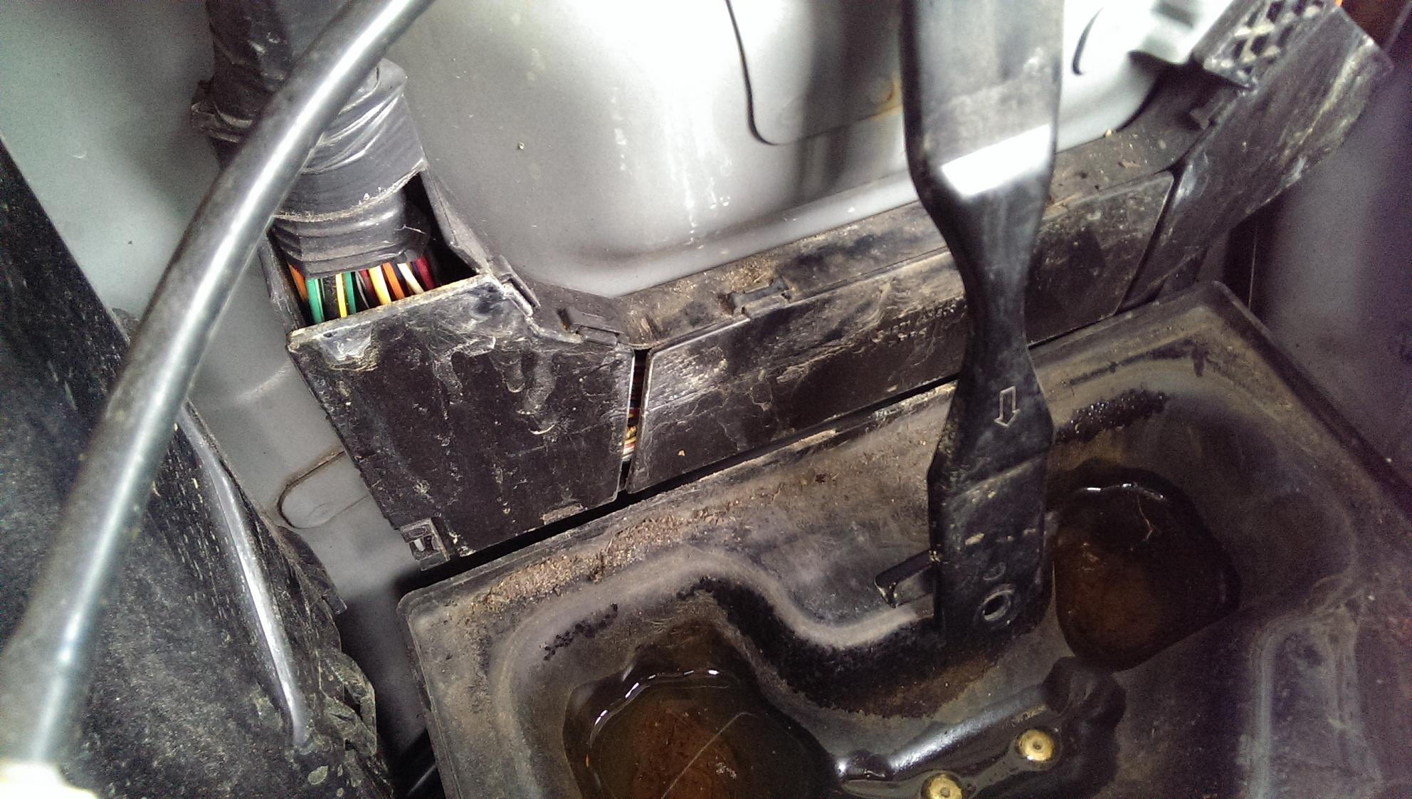

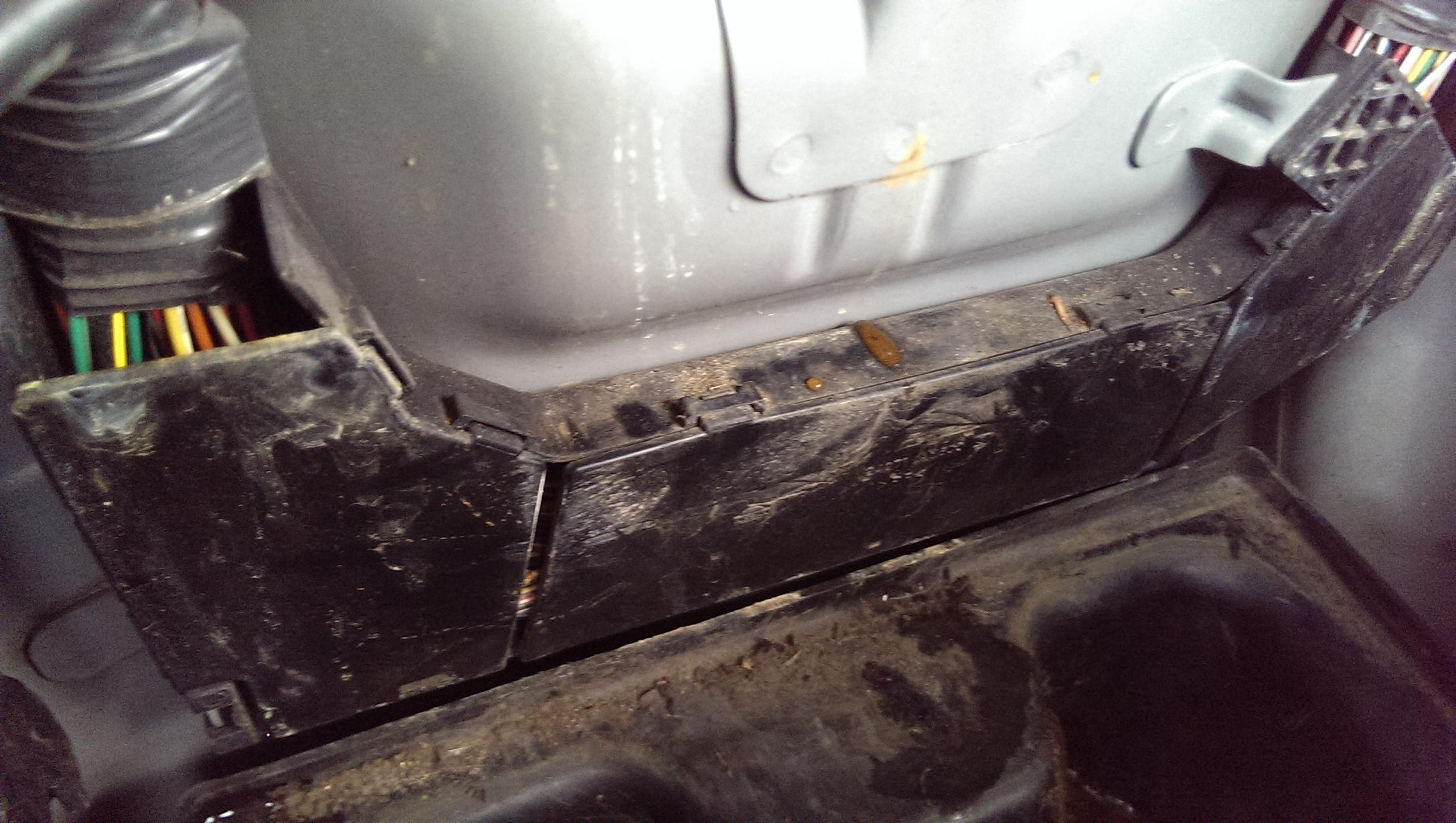

After yanking battery to replace last night, I discover a ton of water pooled in the battery tray, and dirty water trails all up in the electrical box behind it, picture attached. Also attached picture of water traces on battery. Keep in mind, the pooled water is just what's left after 5 days of sitting. I'll be contacting the nissan tech with pictures today to see if this could have caused the odd behavior of my electrical components, and whether it could be a concern in the future.
Was hoping someone here has any experience with this, and if anyone knows exactly what that electrical box is? I can't take it apart and investigate yet, because insurance hasn't seen it yet.

Electrical box is your IPDM (intelligent power distribution module). It can create wonky electrical issues when you get water into the compartment. You might need a new IPDM and labor to put that in. I would test the alternator as well and make sure it is good along with battery at an autozone or parts store for free.
