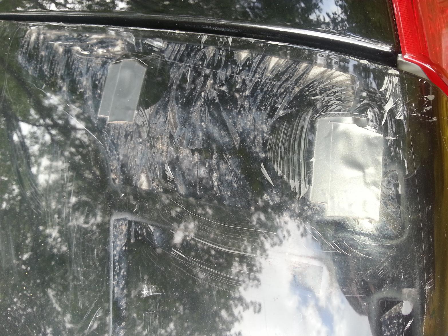

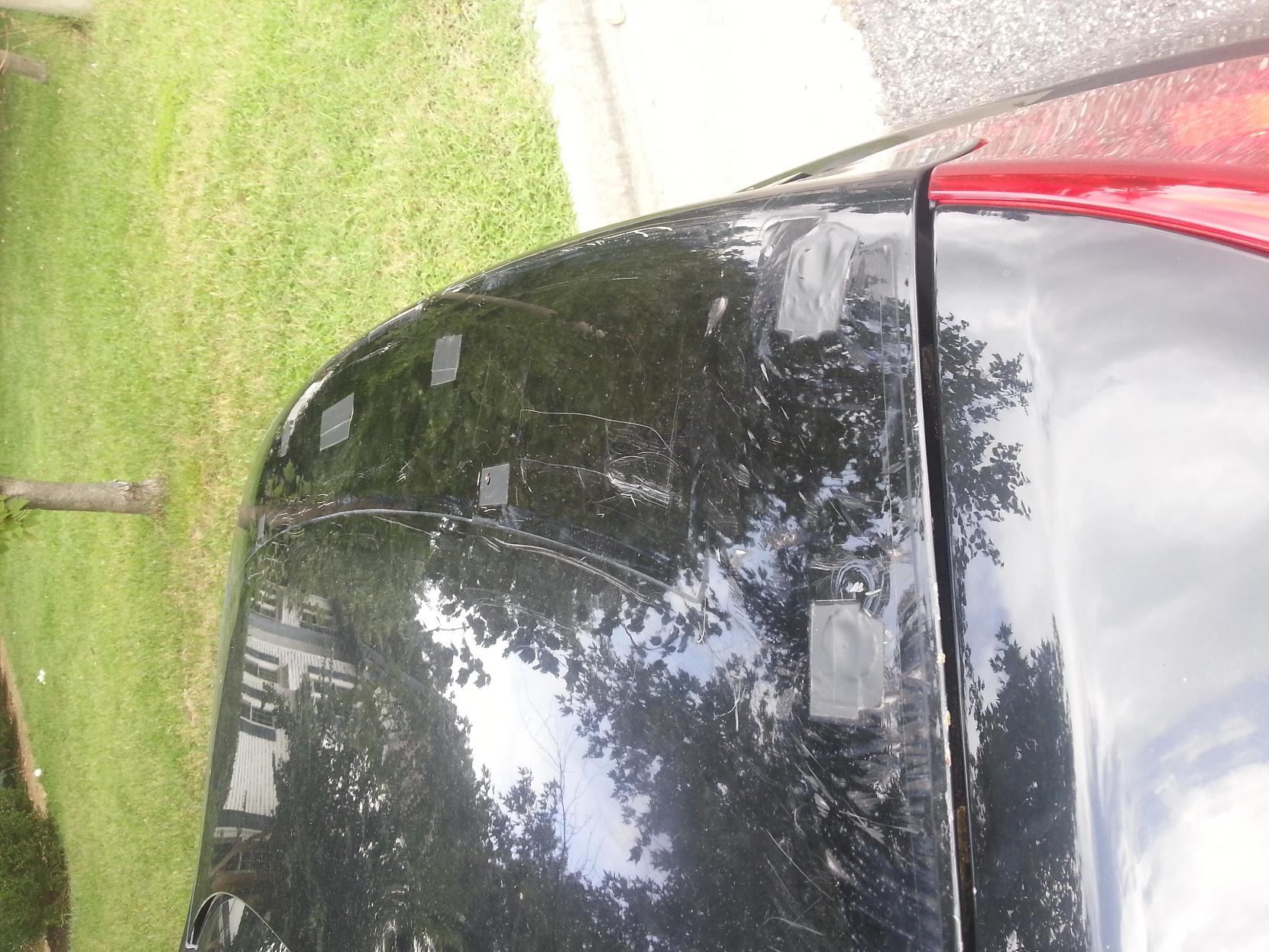

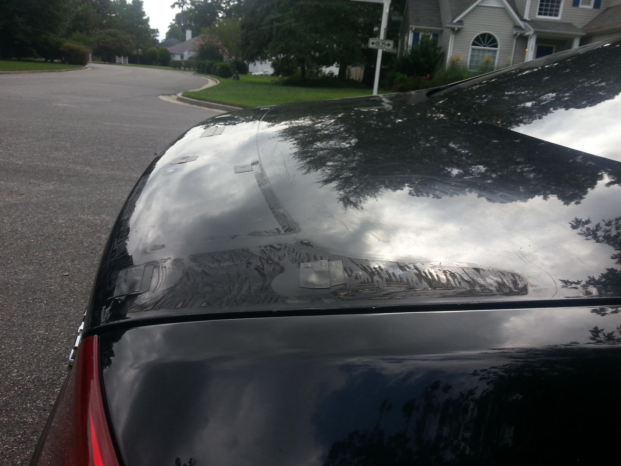

You were right the one in the window wasn't even connected because of the spoiler. And since its an 03 that led was sitting for so long it took some fiddling but she's working.Thanks man!Here's some of those pics just for kicks to show what that douche nozzle did

Youd figure the least he would do is eraser wheel the adhesive off and put the circcular clear sticky tabs on the holes(kinda what ford puts on the mustangs with the mock hood scoops)not electrical tape.But oh well replacing the deck lid is next on my list of things to do.Urban, thanks again mate!
