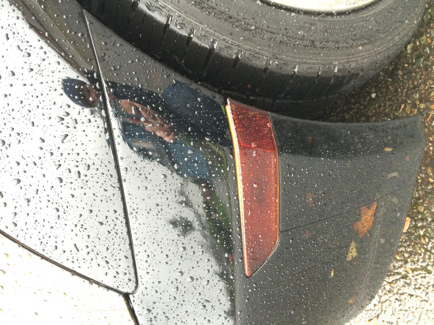

Hey guys, I let someone drive my g35 and while he was parking came to close to the curb and rubbed the front bumper into the curb, a couple of those plastic clips fell out from the plastic around the wheel and I bought new clips so I fixed that,
But on the drivers side of the bumper all the way at the end, the bumper sticks up a little above the light and looks bad, I uploaded 3 pics, first one is the current picture of bumper, second is if I push on it slightly, and 3rd is the passenger side of bumper and how the drivers side is suppose to be.
Does anyone who is good with the g35 bumper/panels know the exact problem is like if it's a clip or screw that broke or how to fix it?

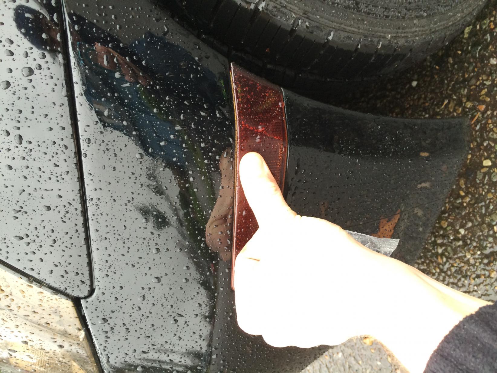

Second pic

Need better pics. Can't see what yer talking about.

Ill try to get better pics tomorrow, but if you look at the first pic, right above the light, there is a strip of yellow, which you don't see in the second or third pic,
Old Nov 28, 2014 | 08:37 PM
JKL1031's Avatar
Joined: Dec 2012
Posts: 1,990
Likes: 111
It's gapped. What u seeing is the foam that is worn. U should take the light off and pry the clips out to get a tighter fit.

This is normal. You probably had this before the scrape. What jkl said you could do but it won't be much improvement. I have it too and just ignore it.

Double sided tape behind the side marker. No need to take it to a shop, they would probably laugh haha

you could just buy some new markers.

So the problem is with the light markers and not the bumper?
Old Nov 28, 2014 | 11:13 PM
JKL1031's Avatar
Joined: Dec 2012
Posts: 1,990
Likes: 111
it should.
