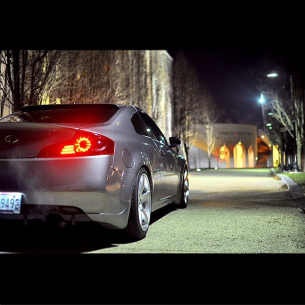

I'm running VMR Wheels 19x9.5 +22 all around with 10mm spacers in the rear for an effective offset of +12. They are wrapped in 255/35/19 up front and 255/40/19 in the rear. I went with this setup because I wanted a meatier fitment without a stretch. As you can see it's pretty flush. My fenders are rolled so there's more clearance. Also I have a rear camber kit but no front kit. Usually, you can get by with just a rear kit. I only have about 2 degrees i the front. Here's a photo for reference.

I'm on 350z s-techs as well. If you're going to get 8.5 and 9.5 width wheels, I'd go with the 225 and 245 I mentioned above. You shouldn't have any problems with fitment. Just make sure your offset is about 15-25. That will give you the best fitment. Anything more than that and you might have trouble getting it to fit. And don't forget about camber kits if you don't want camber, and consider rolling your fenders if you have to.
