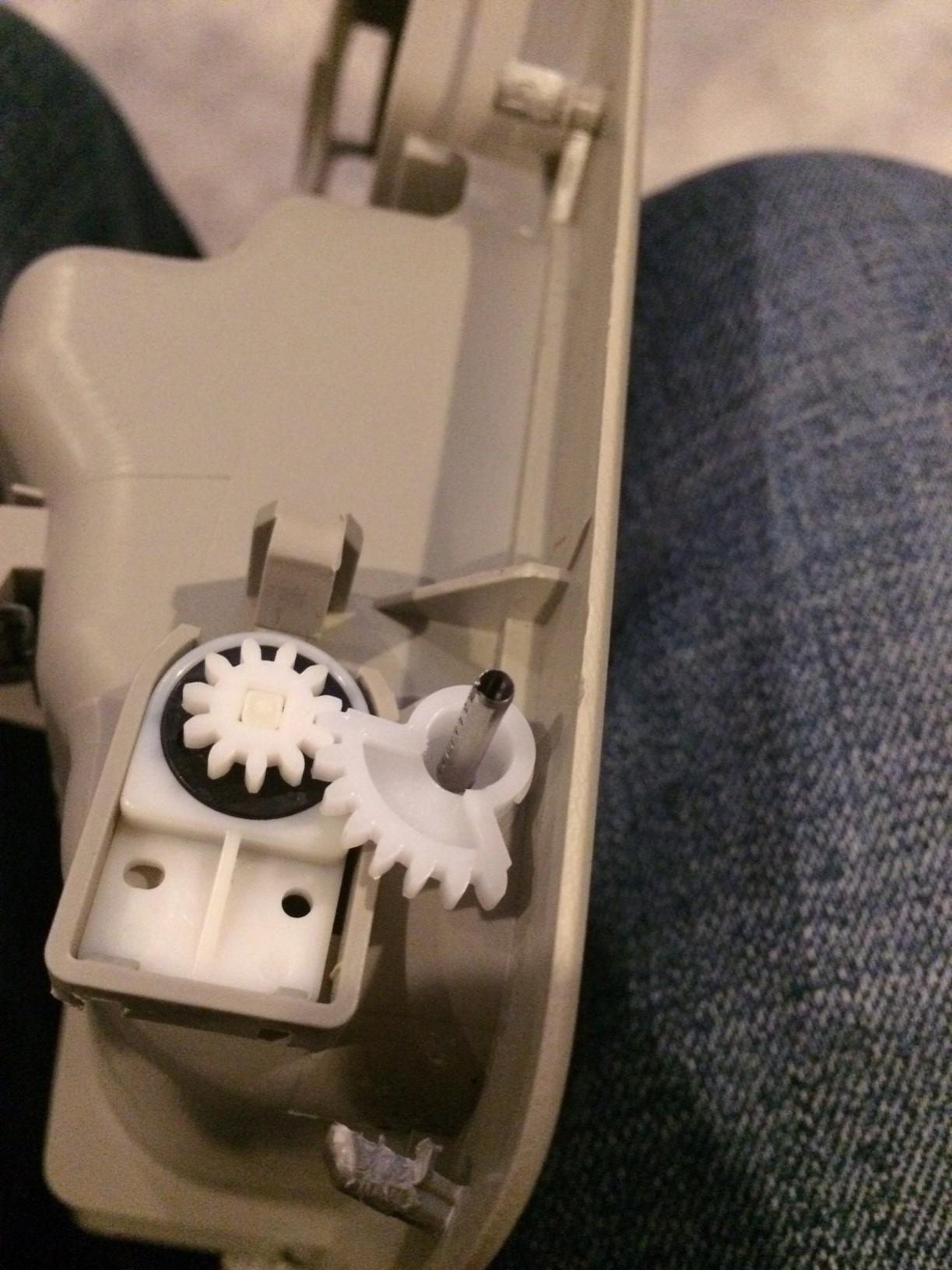

can someone tell me how to take this hinge apart? I have no idea how to take it apart. I want to get it in there so I can properly paint it
I have to at least get the top / left gear off first before I unclip the bottom gear assembly which looks to be clipped in
Attached Thumbnails how to disassemble dome / sunglass holder thing-img_7843.jpg

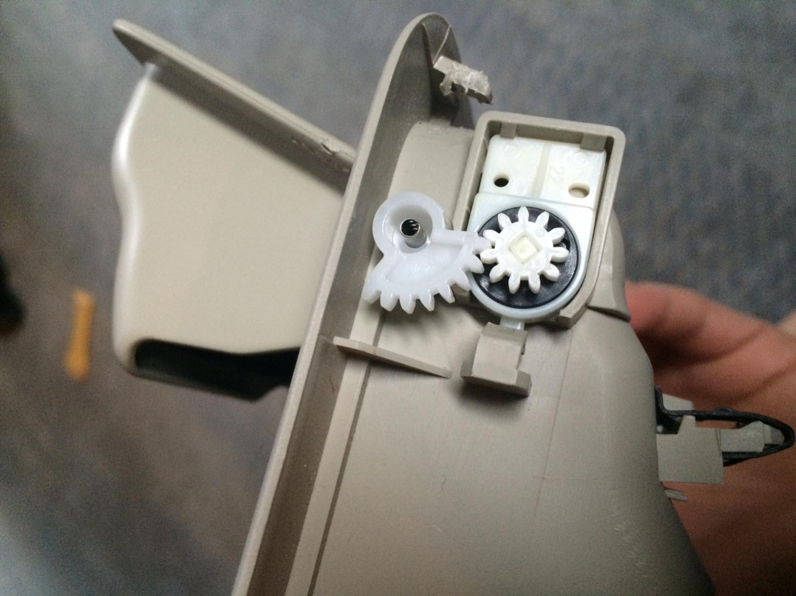

like how do I get this half gear thing off
Attached Thumbnails how to disassemble dome / sunglass holder thing-img_7843-1-.jpg

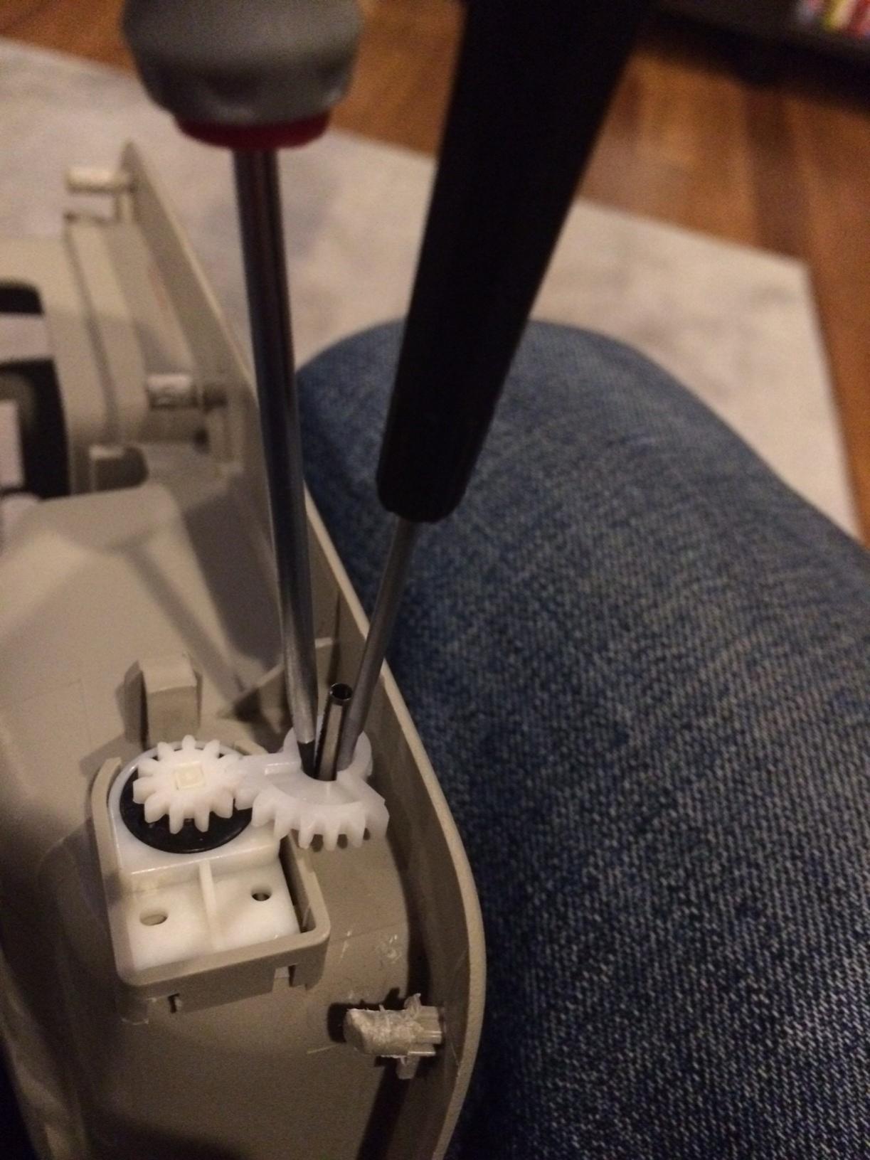

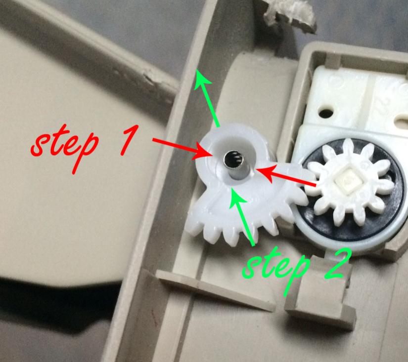

well i got it. its basically a little ring that goes all the way throughout. here are some helpful pics for people looking to disassemble this in the future.
i took two small flat head screw drivers in there and pinched in and it popped out. dont use too much force, you dont want to bend the thin ring. the white gear just pops out, i stuck a couple trim removal pieces under and just pried it out with equal force on both sides. then after that the sunglass holder just slides out
