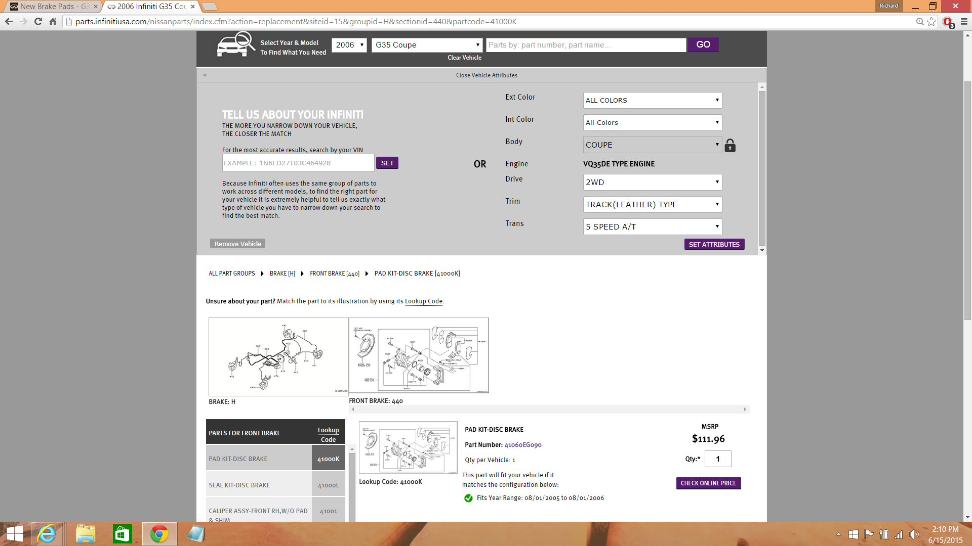

That's weird, I called a local Infiniti and Nissan dealer and asked them what pads they use for my year/model car and they both said they use D1060-1NC0C.
When I searched this OEM number, it did not list it for my year or model car . . . .

Originally Posted by Mustang5L5
What's the difference between than and D1060-Ej20A
Nothing they're both the same I guess. The official Infiniti Parts site uses the part number I posted but dealership sites like infinitipartsusa use the one you gave.
That P/N doesn't look right.
