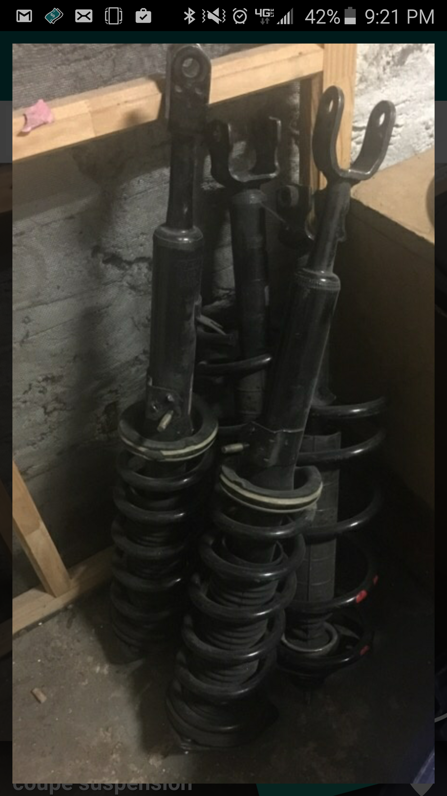

I saw these on Craigslist and was wondering if theres any way to tell if these are genuine 2005 g35 sports coupe shocks.
I need to replace my. shocks / struts and the person is saying these have 30k milage on them for $200. Is that reasonable?
Are oems best?
Thanks!

OEM struts will have a sticker on it with the OEM part number. OEM struts are also made by Tokico which is stamped on the struts.
Not sure on the price but I have seen them go cheaper. New they are $200+ a piece if that helps.
If I am not mistaken only the rear springs are different on sport packages.

Who cares? There are better aftermarket options at affordable prices that are brand new. Used suspension parts are almost never worth buying (unless its a solid, non jointed part with no bushing). KYB shocks with your stock springs would be better, brand new and not much more expensive

But I heard KYBs are really bad compare to stock / Tokico. The car has 155k on it, should I change the springs as well? From the picture can you tell if they are solid/non jointed part?
How much are the kybs for the fronts /and the rears?

thanks - how can i tell the rears are from the sport package.

I also read somewhere about red dots -- are those on the shocks / struts as well? what does the red dots mean? *THANKS!

They are not a solid/non-jointed part. He meant don't buy suspension components used if they, by their function/nature, have moving parts. Shocks obviously have moving parts, so used is probably not the route to go. A sway bar, by contrast, would be a solid metal, non-jointed piece that you're probably fine with buying used.

The KYBs are great. I've had them on for 60k miles now and I'm mildly lowered.
I would also consider replacing your compression rods, lower control arm bushings and steering knuckle ball joints.

No, there are plenty of options for suspension parts now. Mevotech is the most affordable (rockauto.com) and they're a fine replacement. You could get both compression rods and both LCAs for about $200. OEM is SUPER expensive and don't forget that they're the parts that failed in the first place.
If you really wanted to tighten everything up you could get new comp rods (comp rods have to be new cuz of irreplaceable ball joints), but replace the bushings with polyurethane, and then reuse your current LCAs but replace the bushing with polyurethane. You gotta get the old bushings pushed out tho.
