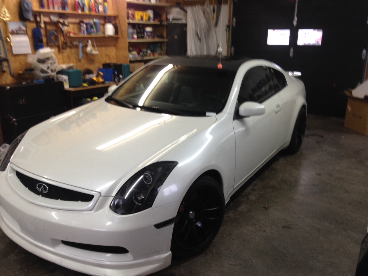

I've recently, against many recommendations, purchased Eagle Eyes dual halo projectors in black trim for my Canadian 04 G35 6MT coupe. As a lot of you have pointed out, the light output is sub par, but I think the lights themselves look nice and fit well since I have a black roof, black rims and black tails/sides. Attached is a bad picture of my car, dirty.
That being said, does anyone know what projector would fit properly into the housing if I wanted to do a projector replacement for the low beams (type and size)? Could I simply replace the lenses and shim them properly to get the proper focal point with the bowl that is already used? Any other options? Now before anyone mentions it, I know I could take it apart and measure the lens, etc. but I want to minimize downtime and was hoping someone may have some info from experience.

when you say "bowl" are you referring to the projector shrouds? you have to remember some of the projectors are long and you won't be able to put the dust covers on the back again. Morimoto Bi-Xenon Mini Stage III H1 are pretty nice, but in most cases you'll have to fab up your own mounting brackets. and aim the headlights mounted on car (not fully assembled, you don't want to have to take it all apart again)
I don't think you would be able to just simply replace the lens

It is not as simple as just changing the lens.
He would have to go with the FX35 projectors for an actual upgrade in visibility, unfortunately losing the dust caps. I mean the replicas of them, but you get the idea. Or... You could buy projectors from the OEM 06-07 car.

By bowl, I meant the projector housing actually. I was referring to changing the lens while keeping the existing housing in place, if it is possible.
