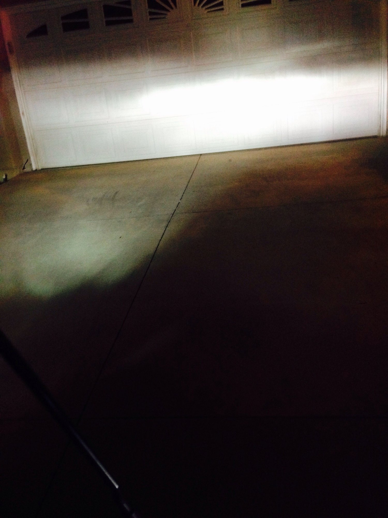

hey guys bought some kensun 6k hid bulbs off amazon to upgrade the shitty lighting on the 2005 coupe and after I had put the wheels back on and everything I thought I was done! I waited til it got dark and when I turned them on was surprised at how different each side looked . Not the color or anything but the driver side seems much brighter and shines on the ground a lot more . I tried adjusting it through the adjustment in the engine bay but it didn't help much . Anybody else experience this ? Here are some pictures: thanks to who ever can help me out !
Also the 6k color don't seem to match up as perfect with the side marker led and the other headlight led as much as I thought .. Should I have gone with the 8k instead ?

Well... Did you make sure to see if your fog lights were on or not? Because what it looks like to me is the fog light on your passenger side is out. It doesn't appear that the light shining on the ground is your headlight. If that were actually the case then there's something wrong with the reflectors in the headlight.

Well my brights weren't on if that's what you mean , yeah seems like it's something with the reflectors inside the headlight should I take apart the housing and clean the inside maybe ? I'm not sure what else to do

No, I said fog lights. Our cars have fog lights that are integrated into the headlight. It appears that you have your fog lights on, and that the passenger side fog light is out.
Check to make sure your fog light is OFF.

Oh **** Okay I see, well the only lights that were on were the headlights , is the fog lights a separate bulb ? I don't think they were on but I'm not so sure now thanks for your help bruh

Yes, they are separate bulbs. Take a look sometime and verify whether your fogs are on or off.

Nice detailed replies guys helped so much. I verified and only the upper lights are on and the bottom lights on the housing were the highs and fogs are were off. I mean the hid bulbs are brand new I don't know why it's reflecting the light differently inside the housing !

do the bulbs look identical? maybe one is damaged.

Is it a D2s bulb or D2r? The d2s bulb I believe has a ceramic coating on the tip. Maybe this will help
D2R bulbs are used in Reflector type headlights. where they are a bit more restrictive of how much light they allow to pass.
D2S bulbs are only used in Projector typeheadlight*where the bulbs pretty much outputs max light and the projector itself cas the metal plate built in to alow a specific cutoff.

D2R have painted/vinyl/etc pieces on the bulb to control the output. D2S is just glass.

Can you confirm the bulbs is installed properly.
Technical explanation for the glare on the ground is that the bulbs is not properly aligned with the reflector, so you have light hitting the reflector features at angles not originally designed.
My first instinct is to make sure the bulbs is seated properly and not cocked. If it is fine, i'd compare it to the original bulbs. A cheap HID bulb might not have the focal point in the right place, so you'll need to compare the two bulbs

def make sure bulbs are seated correctly. this can be a world of difference id they are not. if not seated right, the hot spot could be way off. also from your pics, it looks like the drivers side is way higher up than the passenger.
